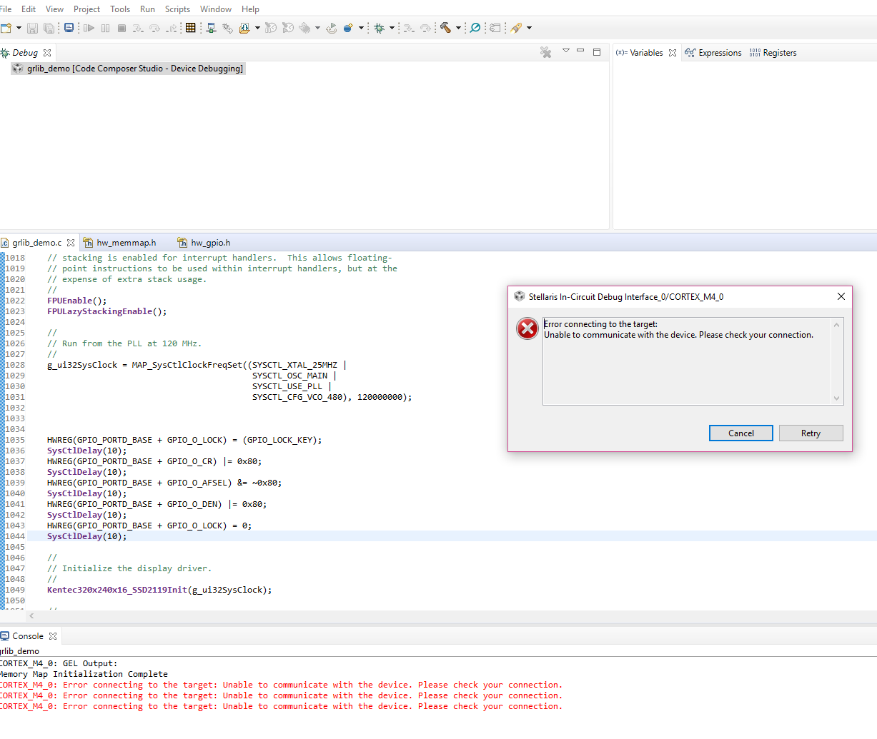

I am trying to run the grlib_demo with LCD Booster Pack.
Since the Display was not working so i was searching around to see what is the issue and how to fix. Based on a post on e2e, I tried some modification and flash the device. Since then it has stopped communicating any more.
Here is the snapshot of the code I introduced (From Line #1035 to 1044) and the error is shown as well.
Please advise.

    You intent is trying to use the NMI pin as the GPIO, correct? You would've locked the device from JTAG access if you configure the JTAG pins for GPIO. However, this is not what you are doing. Not sure why the debugger is not connecting to the target. Please try to unlock the device by following the below steps.
    1. Unpower the board and press reset
    2. Power the board but do not release the reset
    3. Run the JTAG unlock sequence according to the LM programmer "dialog box"
    4. Power Cycle the board
    5. Do a Flash Erase Check or load a simple program to confirm the debugger can access the MCU again
    Please use below code to configure PD7 for GPIO.
    HWREG(GPIO_PORTD_BASE+GPIO_O_LOCK) = GPIO_LOCK_KEY;
    HWREG(GPIO_PORTD_BASE+GPIO_O_CR) |= GPIO_PIN_7;
