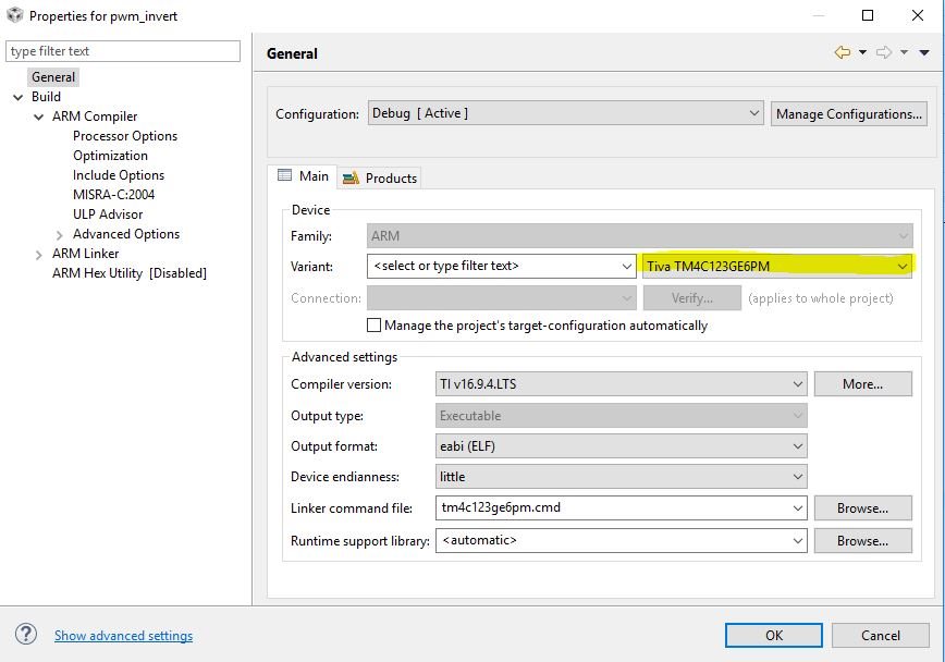

     Do you mean the project will not compile if you choose PC4/5?  How did you create the project? Did you select Tiva TM4C123GE6PM like below?
