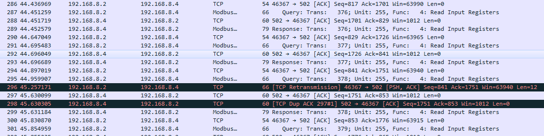

In my application Modbus TCP protocol stack is integrated with TI RTOS and it was working well earlier. i.e. we will be able to continuously perform read/write operating on modbus tcp commands. Now we have been observing below error message in the console and there after that no response for even ping command.
00035.600 TcpTimeoutRexmt: Retransmit Timeout
00039.200 TcpTimeoutRexmt: Retransmit Timeout
00041.100 TcpTimeoutRexmt: Retransmit Timeout
00041.800 TcpTimeoutRexmt: Retransmit Timeout
00046.900 TcpTimeoutRexmt: Retransmit Timeout
00048.100 TcpTimeoutRexmt: Retransmit Timeout
00048.800 TcpTimeoutRexmt: Retransmit Timeout
00051.300 TcpTimeoutRexmt: Retransmit Timeout
00056.800 TcpTimeoutRexmt: Retransmit Timeout
00062.400 TcpTimeoutRexmt: Retransmit Timeout
