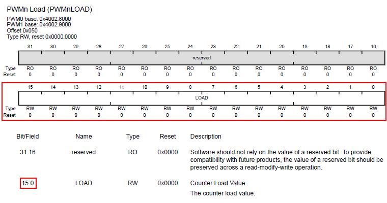

  • Dear all, I tried something simpler as cb1_mobile suggested and with PWM as the others kindly recommend. I got now the 1.4 MHz signal (thanks) but I cannot produce a 25 Hz signal,  it goes to 1.4 kHz, could you take a look into my (failing again) code please?
     unsigned long ulPeriod;
        unsigned long u2Period;
        SysCtlClockSet(SYSCTL_SYSDIV_2_5 | SYSCTL_USE_PLL | SYSCTL_OSC_MAIN | SYSCTL_XTAL_16MHZ); //for 80 MHz
       SysCtlPWMClockSet(SYSCTL_PWMDIV_1);
        SysCtlPeripheralEnable(SYSCTL_PERIPH_GPIOF);
        SysCtlPeripheralEnable(SYSCTL_PERIPH_PWM1);
        ulPeriod = SysCtlClockGet() / 1400000;
        u2Period = SysCtlClockGet() / 25; //
        GPIOPinConfigure(GPIO_PF1_M1PWM5);
        GPIOPinConfigure(GPIO_PF2_M1PWM6);
        GPIOPinTypePWM(GPIO_PORTF_BASE, GPIO_PIN_1 | GPIO_PIN_2 | GPIO_PIN_3);
        PWMGenConfigure(PWM1_BASE, PWM_GEN_2, PWM_GEN_MODE_UP_DOWN | PWM_GEN_MODE_NO_SYNC);
        PWMGenConfigure(PWM1_BASE, PWM_GEN_3, PWM_GEN_MODE_UP_DOWN | PWM_GEN_MODE_NO_SYNC);
        PWMGenPeriodSet(PWM1_BASE, PWM_GEN_2, ulPeriod);
        PWMGenPeriodSet(PWM1_BASE, PWM_GEN_3, u2Period);
        PWMPulseWidthSet(PWM1_BASE, PWM_OUT_5,ulPeriod/2);
        PWMPulseWidthSet(PWM1_BASE, PWM_OUT_6,u2Period/2);
        PWMGenEnable(PWM1_BASE, PWM_GEN_2);
        PWMGenEnable(PWM1_BASE, PWM_GEN_3);
        PWMOutputState(PWM1_BASE, PWM_OUT_5_BIT |PWM_OUT_6_BIT, true);
           while(1)
  • Had you reviewed - as past directed - the  "requirement forced upon (ulPeriod)" when contained w/in "PWMGenPeriodSet()?"      Does that not prove a (very) likely suspect?
    Now its not my desire to, "Do your job for you" - yet I will "hint" here that your use of the  "PWM Generator" ...  "Giveth - but (sometimes) Taketh Away!"
    You did not remark upon your (somewhat unusual)  "1000:1" difference in PWM Output Frequencies - even though - especially though - your divisors, "Exhibit NO SUCH relationship!    (i.e. 1.4M & 25!)
    That's of  key/critical note - is it not?     (and (sorry) should NOT have been missed!)     Do you (now) see your issue?

  • What ... (already) solved problem?     Poster noted: "Only achieve 645 kHz!"
    Far from solved - (some) would say...    (a "more correctly guiding" solution - appears above...)
  • I was thinking wrong about the response. Feel kind of stupid I did not pay attention on that but thanks so much for the guidance
  • No one "wants" such a "feeling" - you're surely clever enough to spot such (unusual) occurrences (1000:1 ratio)  such should be Noted - should it not?
    You need to "better focus upon ALL clues" - that's NOT at all (low-intellect) - poor awareness better describes.      (and for a 2nd here - as well.)
    Fortunately - even though (banned) here, "KISS" very much - assists that effort!    (extra focus - aids/amplifies awareness)
    Thanks your verification - yet you've not (yet)  "Seized upon" the reason for the 1000:1 ratio" - and (someone) here - (still) believes - that will AID your understanding/make you stronger...
  • Fly west early tomorrow - (thus unlikely I'll be here) - to reduce frustration -  comes now ...  (another) clue.
    Might you be,  "Trying to stuff-in" -  more than this (particular)  "bag of stuff"  (yes, "stuff")  - may  (reasonably) hold?     For "extra credit" - from where did the 1000:1 "frequency ratio" (as you earlier reported) arise?
  • Had this forum penetrated w/in the hallowed halls of "Bronx Sci" ... the "extra credit bin" would (now) be, "OVER-FLOWING!"     Pity...
    Crack millennial staffer offers up,  "0xD400"  as one further clue...   (it is feared that her effort - may pass unrecognized...)
