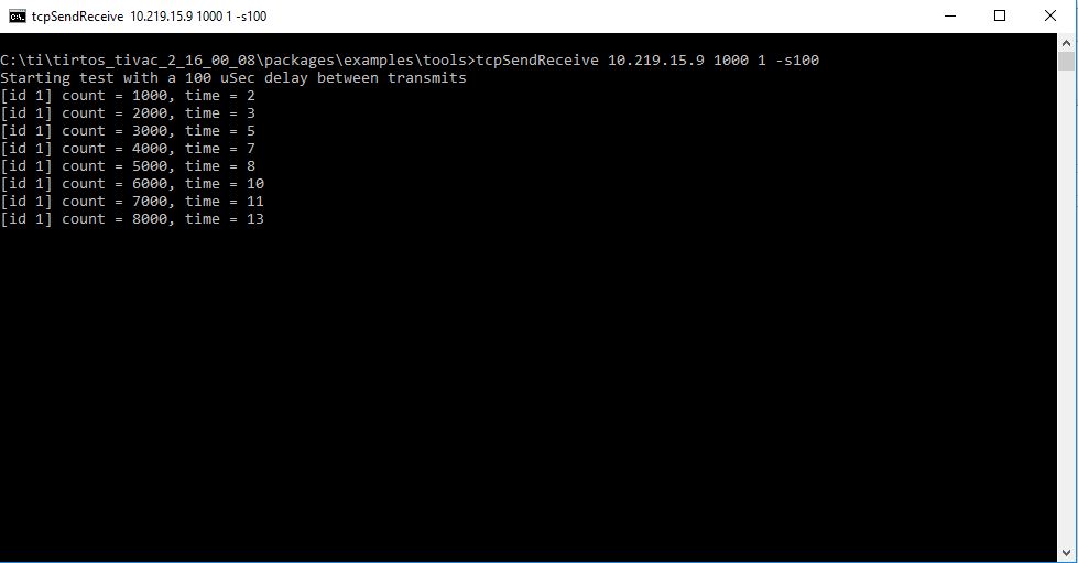

  • Did you connect your board to the LAN? It is supposed to acquire a DHCP IP address from your DHCP server on your network. You should see something like below printed on the console. Your DHCP server will lease you an IP address. Note your IP address may not be the same as mine.
    System provider is set to SysMin. Halt the target to view any SysMin contents in ROV.
    Service Status: DHCPC : Enabled : : 000
    Service Status: DHCPC : Enabled : Running : 000
    Network Added: If-1:10.219.15.9
    Service Status: DHCPC : Enabled : Running : 017

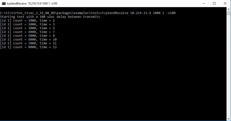

    Once you know the IP address then you will go to your PC command window and type
    >tcpSendReceive 10.219.15.9 1000 1 -s100
    and you will see messages such as the following begin to appear on the terminal window when a TCP packet has been echoed back.
