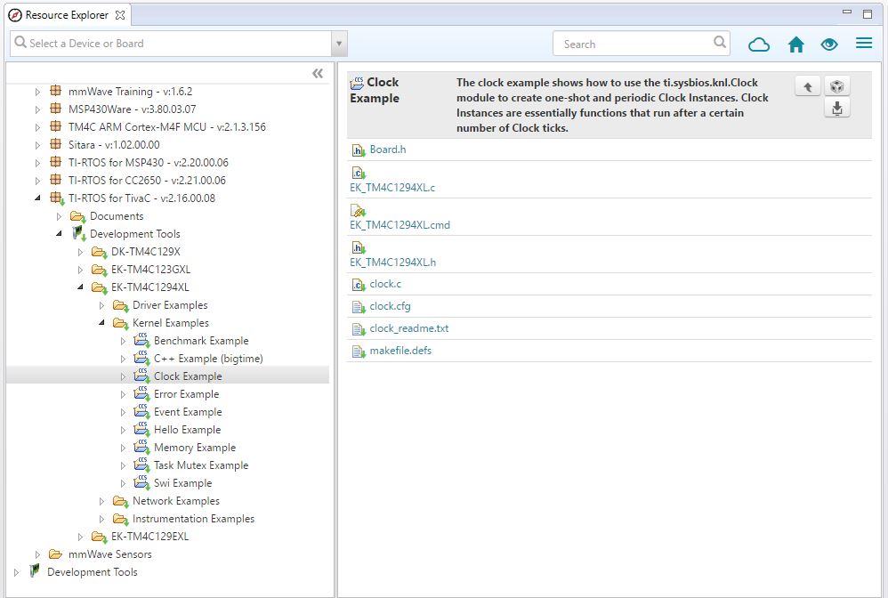

I have started to the TI-RTOS workshop training series. According to the video Labs I am trying to solve Hwi usage. I try to use Hwi with Timer2A. But I faced with some issue about usage of Hwi and it's logic.
In the example that I try , led should blink every 1 second according to the Timer2A based Hwi.
This is the code;

When I tried that code the blink is not working. When I look at other posts there are another type of usage like by setting a clock 1 second period clock and triggering function which we created for Hwi function. I did not understand why we are creating the Hardware interrup and setting it's function.
Is it just for preemption or just for setting ISR priority and interrupt type.?
It would be very helpful to understand basic concepts by examples and it is structure, why we are defining a Hwi function and after that why this function should be called from another object like clock.
