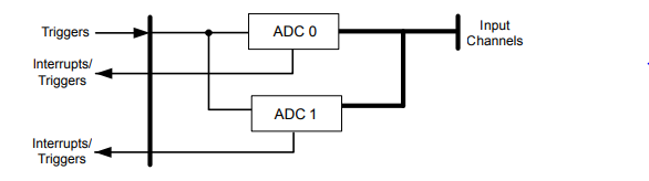

Good afternoon fellow programmers, I have been trying to develop an ADC program the last few days, so I stumbled upon a problem. I have configured both ADC0 and ADC1 with sequence number 2 and I would like to read separate informations i.e.: Pins PK3 to PK1 reading and sending its values to ADC1 and Pins PE3 to PE1 reading and sending values to ADC0. I've already configured the pins, but when I call the ADCSequenceDataGet (Im using 2 different uint32 variables to store the infos) the same information is on both ADC0 and ADC1 channels. Is there a way to solve my problem? Im going to attach the code.

  • Please do not consider UART configurations and code. I was using it for another application.
  • I thought you said you wanted to use the sample sequence 2 for both ADC0 and ADC1. But you areconfiguring sample sequence 1 for ADC1 instead. Your code below.

    Also in your interrupt ISR you only wait forADC  interrupt flags to set but you never clear them after you finish waiting. They will remain set. You should insert         ADCIntClear(ADC0_BASE, 2) before you read the ADC data. See below.

  • Oh, sorry, I changed the sequencer to 1 for testing purposes and I forgot to change it.
  • Do you still have the problem then? Did you implement the fix I highlighted in red?
    I will suggest you first start with testing one ADC only. Make sure you are getting the data you are expected for each ADC samples and then combine both ADCs in to your final project.
  • I did implement the code highlited in red, although it is still giving me the same error. I have already developed another ADC reading program for only one ADC, and it worked fine. This one is also working fine, it is reading what is expected, the problem is that both uint32Value and uint32Value2 have the same values in them. I dont know if it is possible to do what I wish to do since the ADC0 and ADC1 have shared input channels, as highlighted in the image.
  • Your problem is not fixed in the below code. If you want the ADC1 to sample pins PK3 to PK1 then these are not channel 0,1,2 but should be channel 17,18,19.

  • Thanks, that completely solved it!
