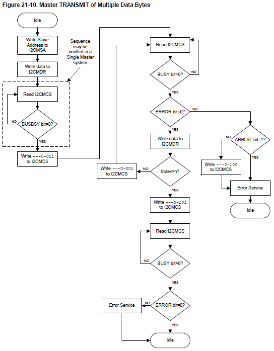

TM4C129XNCZAD: I2C Master TRANSMIT of Multiple Data Bytes Issue
Part Number: TM4C129XNCZAD
I am trying to follow the flowchart given in the datasheet to transmit 4 bytes out from I2C. However, I can only manage to see 0x34 and 0x78 being transmitted out from the scope while the other 2 bytes lost in the air. Below is the code and flowchart for reference. Need a second pairs of eyes to see what I have missed in my code. Thanks.
My code:

    Cb1 provided many suggestions and debugging tips. Why don't you stop your I2C transmission after 0x12 is sent out? Can you get 0x12 to work if you don't do the next three words?

    Hi. it works for 1 byte transmission. Below is the code I used.

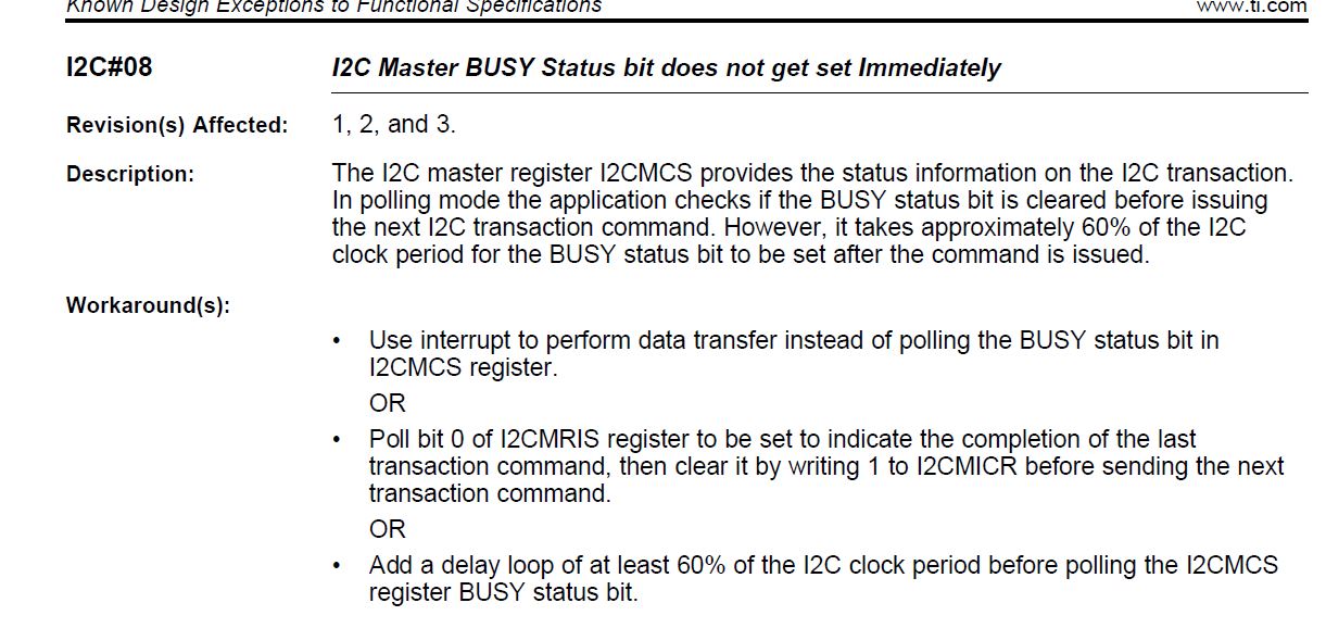

    In fact it works perfectly after I implement the check on interrupt instead of checking on the status register as indicated in the flow chart. I am just wondering if the flowchart implementation is really working. Perhaps TI engineers can help to verify this. Below is the working code.

     Glad you resolve the problem using interrupt which is the workaround suggested for the below errata.
