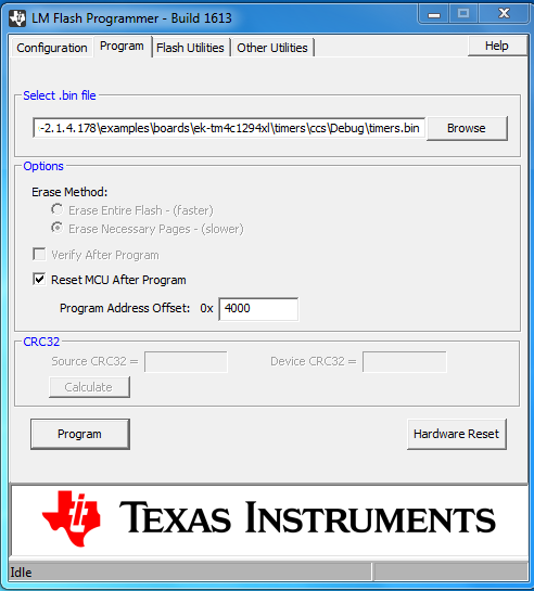

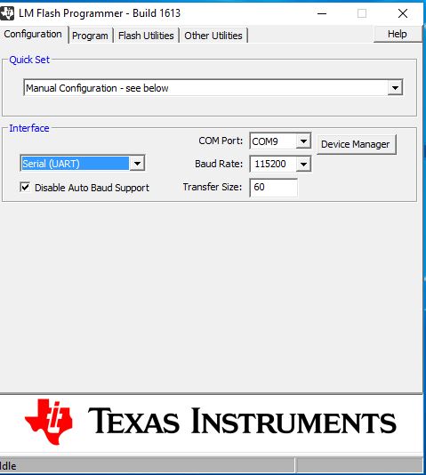

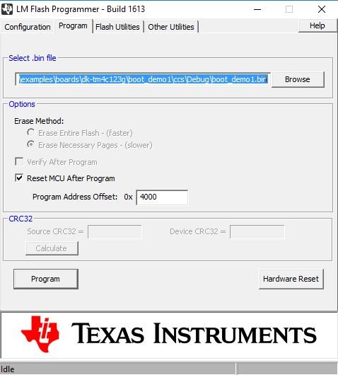

     Didn't you try the TivaWare boot_serial example? You use the LM flash programmer to load your application firmware like below. First specify the UART interface and next specify the .bin file to upload to the MCU.
    Respected sir,
    Thank you for the reply. You have said that, i have to specify UART interface and .bin file. In snap you have used boot_demo1.bin file. But what if i have to download other example like timer??
    1. Can i give a path of timer.bin instead of boot_demo1.bin as shown in attached snap??
    2. Also can i use the same method to download uartecho (with and without modification) example from TI-RTOS??

    You can use the LM Flash Programmer to download any .bin file (i.e. a simple blinky example if you want). But please go through the boot_demo1.c example and see how it transfers the control back to the bootloader. What I mean is that you need to build some intelligence into your application firmware so that if you want to update your firmware again, the application will transfer the control back to the bootloader. The boot_demo1.c current relies on the switch being pressed as a method to transfer the control back to bootloader so a new firmware can be updated. If you want to upload the uart_echo TI-RTOS example, you need to modify the example first. Otherwise, it will become a one-time update.
