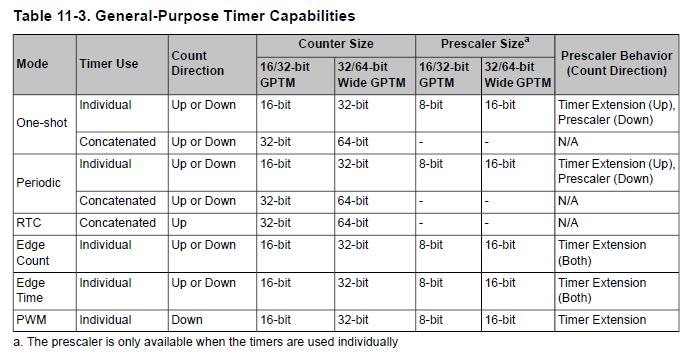

We're trying to implement frequency counter by TM4C129DNCPDT, Can someone guide us is it possible use GPIO or CPP pin to measure external input 12MHz clock?

  • It is expected that the use of a, "CPP pin" - just as you noted - should work best.
    Unstated is the "source" of this, "external, 12MHz clock." Usually best results flow from the shortest, most direct, signal introduction - and try to insure that (any other) HF signals do not run "near" (or especially in parallel) w/your external signal.

    Your identification of - and insertion - of a, "Higher Speed Capable/Accepting" Frequency Dividing IC (placed between your "external frequency Source" - and the MCU's CPP pin) - will  extend the frequency range of your project  - and likely will make it  more robust...

    Follows the various clock/timer modes - for this vendor's (smaller, '123) MCU)   (should be highly similar to your device - in this "Timer" regard)
    It would appear that (either) "EDGE-based" Mode - best serves you.     But which - and when - and (even) WHY?
    Experience teaches that your solving for (only) this (rather restricted)  "12 and only 12MHz"  measurement - will NOT produce,  "Full Learning!"     Would it not prove advantageous - to instead - extend your (high "accuracy) measurement  to encompass:  0.1Hz to beyond 100MHz?
    When might you switch from,  "One EDGE Method" - to the other?     And - can that "switching" be automated - so that the MCU performs the,  "Heavy Lifting?"

    To add to cb1's comments, you can also search E2E for other users who have tried to measure input signals via the CPP to see methods they used. As we don't have an example in TivaWare which does this, you will need to develop or re-use code from other community members. As you are coding if you have issues with the implementation please feel free to post to receive further guidance.

    Keep one thing in mind however -  the most powerful - and greatly aiding, "KISS" - is (in my opinion)   inadequately promoted here.     As a (predictable) result - most e2e users attempt their  "EDGE-Keyed" measurements via,  "ONE and ONLY ONE TIMER" - which while (maybe) possible - proves  FAR HARDER & TIME CONSUMING TO IMPLEMENT -  THAN THE  (VASTLY) SIMPLER USE OF "TWO TIMERS" - EACH "DIALED INTO" A SPECIFIC TASK!      And that   "simplification - and  speed-up" is clearly,   "KISS!"
