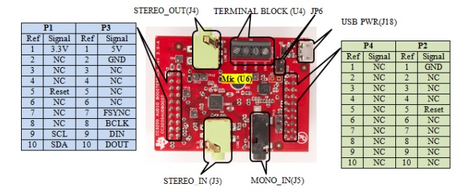

Hello Everyone,
I am currently working on  Signal processing algorithm implementation  on ARM Cortex M4. I want to run some basic  Audio processing algorithms and filter implementation.
Texas instrument have come up with CC3200 Audio Booster pack. As nowhere TI mentions CC3200 Audio Booster with TM4C123
So ,I need to know the compatibility issues between CC3200 AUdio BOOSTER  & TI TM4C123Gxl orelse they are compatible
Please Clarify.

  •   Hello Austin,
    Thank you for getting back to my  query.
    Well i have already checked the schematics for same boards & as per my knowledge i guess they must be compatible and communication can be possible using I2C interface.
    Can you please cross verify it as i am going to purchase the board.
    Pin details of both boards are below
  • Hi Sajad,
    I agree with you--looks like the two boards should be compatible with correct I2C mapping on the tiva device.

  • Hi Sajad,
    The details are all in a file named tm4c123_wm8731_folder.zip which can be downloaded from the link at the end of this message under 'Example programs for TM4C123 and WM8731 using MDK-ARM' in the Browse by Resource menu. Can you not access this? My preferred development environment is MDK-ARM. The code-size limited free version is suitable for the examples in the book. However, in the Browse by Resource menu there is also code for the TM4C123 Launchpad and CircuitCo Boosterpack that is compatible with CCSv6. The main difference is simply in the project files that CCS, vs. MDK-ARM use. It was a bit of a bother I seem to remember to get the CMSIS DSP library into CCS but there are instructions for this in the CCS-version zip file. The differences in the example code are very slight and concern mainly the names/paths of the driver header files and I think there is something to do with aligning data in memory in file tm4c123_aic3104_init.c.
    The CircuitCo Boosterpack used an AIC3104 codec and this was interfaced very similarly to the WM8731/AIC23 codec, i.e. using I2S emulation. Of course the configuration of the AIC3104 and WM8731 codec via I2C is quite different. The PCB design in the zip file is suitable for either the WM8731 or the AIC23 codec (they have slightly different width TSSOP packages) It's been constructed/tested with both devices.

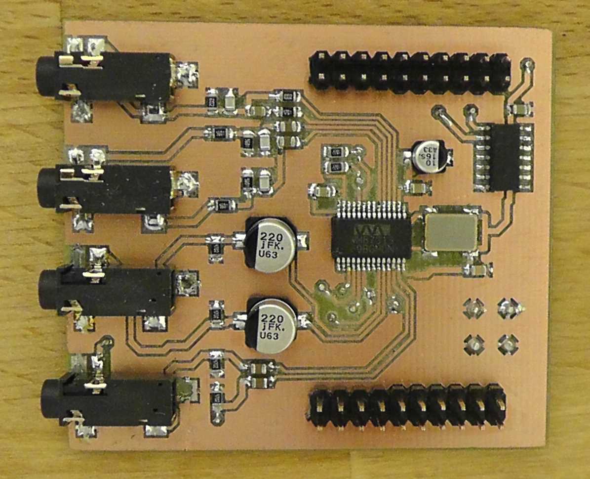

    The Boosterpack is not available to buy but all of its design information - schematic, BOM, Gerber files -  is provided in the zip file so you don't have to design anything, you just have to fabricate it. Back in 2014 with the help of TI's University Programme I approached CircuitCo with essentially that design. The design is referred to in a paper I presented at ICASSP 2014 in Florence, Italy. Two years later CircuitCo had redesigned the Boosterpack based on the AIC3104 codec and a very small number , 25 I think, were manufactured. I have a handful of these and several were distributed by TI's University Programme to university professors for evaluation. Their feedback was encouraging.  I described the CircuitCo Boosterpack in the book in anticipation of its becoming available to buy. CircuitCo advertised the board on their website but ultimately declined to manufacture any more.

    Thank you for the help,all the way.I have given your design files to the PCB design team,they will start working on it and get the exact components required.
    Also i too believe that it should not be very much cumbersome for making it work with CCS design environment.

    I have given your Schematic And Layout details for PCB fabrication, but the thing is they are charging around 134 USD,which is very much of money to design a boosterpack.
  • Hi Sajad,
    I agree that is a lot, although I am inclined to think that's not so much a specific feature of this BoosterPack but because it's for a one-off job. Consider, for example, this $19.99 boosterpack. https://store.ti.com/cc3100boost.aspx What would it cost to make one of these by your route? This is why I attempted, via the Texas Instruments University Programme, to get into an arrangement with CircuitCo (to produce large numbers). The PCB artwork (Gerber files) for the WM8731 BoosterPack are designed specifically not to make very stringent demands of the etching/manufacturing process, e.g. two-sided, no plated through holes. Although this information won't help you, my prototypes were made using a mechanical etching/milling machine and soldered by hand by a technician in my university dept. workshop. The 'cost' of that is, of course, opaque.
    Donald
    Maybe they charge so much because its not a bulk order just a single piece.As it requires micro soldering and Codec IC to be soldered on the PCB,otherwise i would have given it to someone in my team.
    Anyway i will check out with other people & I think it can be soldered on the DOT PCB too.
