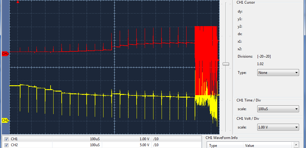

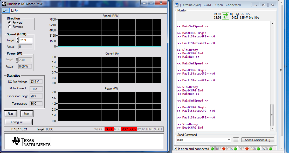

Things get freaky odd when ADC1 SS0/1 are configured for (high speed) trigger source PWM0 versus (low speed) ADCTriggerProcessor() polled 1 second intervals from GPTM interrupt. The actual ADC sampled input signals appear to morph under the same external test conditions. That is to say when the trigger source of ADC1 is slowed down (SS0, SS1) the actual analog input channel signals appear to reduce in magnitude and have fewer or no negative spikes jotting below ground. Those channel signals are derived from monitoring PWM0 module GEN0,1,2 during 20Khz inverter commutation, no motor attached. Part of the issue revolved around UCC27714 not accepting a HI/LI input pulse below 100ns was creating BusVoltage spikes from 24vdc power supply source well above 90V during Cboot PreCharge.
Yet a small motor could be made to run under FOC commutation (7600 RPM), source roughly 400ma from 24VDC switching supply. Startup voltage surge has been corrected via simple tweak of SW though was unexpected TI would change the industry standard gate driver HI/LI rules as to cause mayhem. That motor run is important to note as it proves the MCU driven inverter can produce proper motor commutation yet the Analog COMPS +VREF seems to have other ideas. Yet the Analog COMP fault source outputs C0O,C1O,C2O were disabled in SW to prevent false tripping via external or internal +VREF calibrations. Trying without any luck to correct behavior thus leaving both C0o,C1o,C2o and M0nFault GPIO's disabled.
Three analog COMPS outputs (C0o,C1o,C2o) are enabled and confirmed CCS debug with external +VREF. Yet how can we know GPIO PC6 is actually being configured in the ACEMUX and inputting the external +VREF as expected. How using CCS debug can we verify TP15 +VREF voltage is making way into the C0+ alternate as confirmed in CCS debug?

    I apologize for not recognizing our custom PCB inrush DC current delay FET circuit LO side gate driver was regulating those ground transients. A 680uf electrolytic ground control reacted during any negative transient bypassing Cboot startup transient that ADC0 was rapidly sampling. After removing the FET delay circuit and populating inrush delay circuit with isolated relay contacts the Cboot charge transient could not be stopped by simple SW tweaks to the PWM period.
  • In other words the motor ain't going to run unless the Cboot charge period and any other startup transients can be stopped from POR'ing the MCU. That in mind of course did ring out all MCU, GND VDD pins to also insure no AGND issues relative +REFA input from REF2033 were occurring.
    The trigger source (INA240) output into Analog COMPS driving inputs leverages an isolated TPS735, 3v3 LDO 500ma regulator, pin 3 bonds top side Digital ground to bottom side AGND plane internally. Through PCB bottom (AGND) 2 VIA enter VSON-6 package center pad though far from away from MCU's dedicated 3v3 LDO both pin 3 acquire (quiet) top side digital GND. The apparent bonding of AGND to Digital GND inside LDO package was not recognized until yesterday, perhaps a good measure stopping ground loops between the LDO sources.

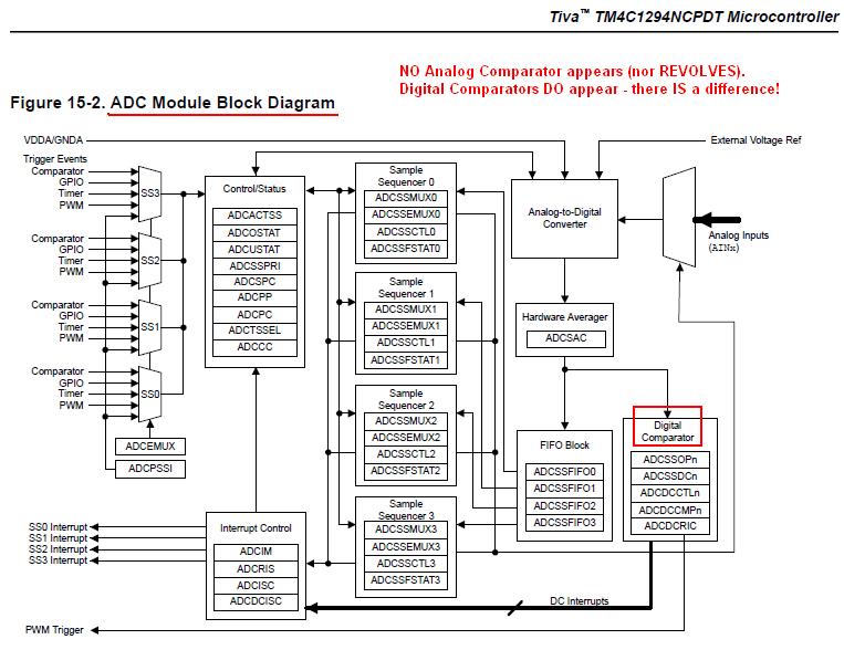

    Analog-to-Digital Converter (ADC)
    An analog-to-digital converter (ADC) is a peripheral that converts a continuous analog voltage to a discrete digital number.    Two identical converter modules are included, which share 20 input channels.
    The TM4C1294NCPDT ADC module features 12-bit conversion resolution and supports 20 input channels, plus an internal temperature sensor.    Each ADC module contains four programmable sequencers allowing the sampling of multiple analog input sources without controller intervention.
    Each sample sequencer provides flexible programming with fully configurable input source, trigger events, interrupt generation, and sequencer priority.    In addition, the conversion value can optionally be diverted to a digital comparator module.    Each ADC module provides eight digital comparators.
    Each digital comparator evaluates  the ADC conversion value against its two user-defined values to determine the operational range of the signal.    The trigger source for ADC0 and ADC1 may be independent or the two ADC modules may operate from the same trigger source and operate on the same or different inputs.     A phase shifter can delay the start of sampling by a specified phase angle.    When using both ADC modules, it is possible to configure the converters to start the conversions coincidentally or within a relative phase from each other, see “Sample Phase Control” on page 1060.
    Nowhere does "ANALOG COMPARATOR" appear here - yet there are THREE MENTIONS OF "DIGITAL COMPARATORS" - your claim of the  "ANALOG COMPARATOR's  REVOLVING" around  "ADC/other Analog Peripheral" - despite (repeated) requests - remains UNSUPPORTABLE!

    ABSOLUTELY - PATENTLY  UNTRUE!     The ARM MCU's "ANALOG COMPARATORS" ...  SUFFER "NO/ZERO" SUCH CONSTRAINT!     Again - from where do you DRAW such UNFOUNDED CONCLUSION?
    Your quote - substantially reveals - your understanding of  "ANALOG VS. DIGITAL COMPARATORS"  to require MASSIVE RE-THINK!
    I HAVE "TRIED MY BEST" - REPEATEDLY - to convey the SURE FACT that the MCU'S ANALOG COMPARATORS - ONCE SET-UP/CONFIGURED - are ESSENTIALLY PURE HARDWARE ELEMENTS - AND ARE UNCONSTRAINED BY OTHER PERIPHERALS!     Note that STILL - after at least three requests - you provide,  "NOT ONE DOCUMENTING SOURCE FACT" - TO  JUSTIFY YOUR (FAILED)  OPINION!

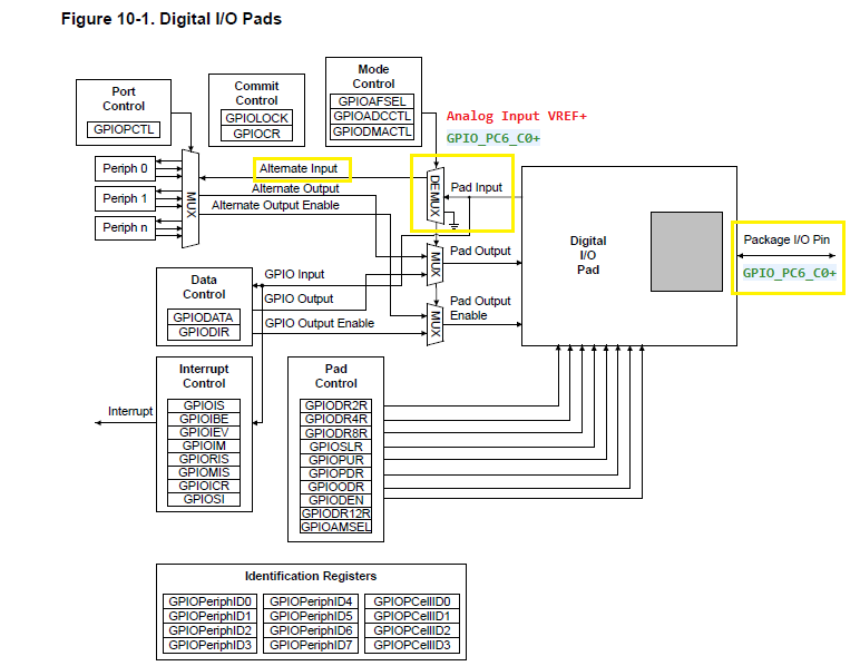

    Again the opening post asked not yet answered, how to verify PC6 +VREF input is indeed being configured on GPIO-C LOCK REG19 (PC0-3), port is locked CCS Debug. There remains the remote possibility PC6 is not getting into ALGCOMPS Co+ (PINO) alternate input. Shared +VREF set 2.8v threshold is (not always) being matched by analog input threshold events, yet always trigger faults. Hence the reason to bring up the intern ASRCP ladder reference was tested at high setting and similar results occurred.
  • And from your older posting:
    https://e2e.ti.com/support/microcontrollers/tiva_arm/f/908/p/422902/1511488#1511488
       MAP_GPIOPinConfigure(GPIO_PC6_C0+);
       MAP_GPIOPinTypeComparator(GPIO_PORTC_BASE, GPIO_PIN_6);
    The (yellow) MUX decode was not listed in the (pin_map.h)

  • Still no help PC6 input, still can't find (GPIO_PC6_C0+) listed in any pin_map.h file. Amit CB1 and I were discussing another topic 2015 PWM GEN fault sources being triggered by MCU embedded analog comparators. Amit advised us both system clocking effects comps output relative to MnFaults being triggered in a different clock domain when PWM clock division. Of that I can believe the ADC/INT triggers on outputs are indeed clocked. Yet as explained when ADC0 is heavily tasked the time it takes comps to trigger PWM0 MnFaults appears to increase.
    Why CB1 is not (GPIO_PC6_C0+) GPIO MUX decode listed in several Tivaware versions of (pin_map.h)? Also disabling GPIO ports part of analog COMPS configured inputs (-C0,-C1,-C2) has no effect to stop Mn0Faults from analog COMPS outputs C0O, C1O, C2O.
    My opinion is GPIO configure was never required to begin with for COMPS inputs and deviates from the typical GPIO analog peripheral MUX configurations. And you question how ADC1 can be effected by COMPS, well the GPIO MUX decode for one when it has been compromised by unrelated SW configurations.

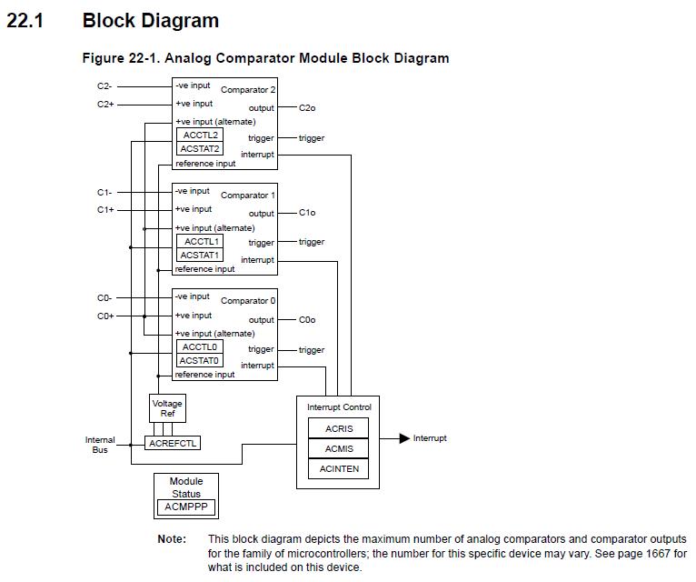

  • Follows a key writing (true copy from "Driver Lib User Guide") - which supports the,  "FREEDOM of the  MCU's ANALOG  COMPARATORS"  from (other)  Analog related peripherals & MCU clocking "entanglements."      (this may require several readings -  especially by those  "opinion only" enthusiasts,  most always,  "Resistant to  hard, vendor supplied, published  fact!")
    Introduction
    The comparator API provides a set of functions for programming and using the analog comparators.    A comparator can compare a test voltage against an individual external reference voltage, a shared single external reference voltage, or a shared internal reference voltage.    It can provide its output to a device pin,  acting as a replacement for an  ANALOG  COMPARATOR  on the board,  * (and no such (external - to be replaced) Analog Comparator has its "Switching Function" so IMPEDED) *    [this writing (added) by cb1.]
    or  it can be used to signal the application via interrupts or triggers to the ADC to start capturing a sample sequence.    The interrupt generation logic is independent from the ADC triggering logic.  As a result, the comparator can generate an interrupt based on one event and an ADC trigger based on another event.    For example, an interrupt can be generated on a rising edge and the ADC triggered on a falling edge.
    It is the PRESENCE of that  "or" - leading that 2nd clause - which CONFIRMS the ABILITY of these MCU-based Analog Comparators - to AVOID,  "any/all INTRUSIVE EFFECTS" - which (may) be introduced by other MCU System elements - even the System Clock - especially the System Clock!     For (likely now) the FIFTH TIME - the  "MCU's  ANALOG COMPARATORS'  SWITCHING OUTPUT FUNCTION" - operates very much - as "INDEPENDENT HARDWARE!"    It is the  ANALOG COMPARATORS' "Trigger and/or Interrupt" functions  ONLY - which may be impacted by (other) system elements!     Again - such is (convincingly signaled)  by the "or" - "PLACED SO SIGNIFICANTLY w/in the API's explanatory write-up."

  • Seems Tivaware makes analog comparator peripheral inputs as GPIO (Digital) inputs incorrectly!
    void
    GPIOPinTypeComparator(uint32_t ui32Port, uint8_t ui8Pins)
    // Check the arguments.
    ASSERT(_GPIOBaseValid(ui32Port));
    // Make the pin(s) be inputs.
    GPIODirModeSet(ui32Port, ui8Pins, GPIO_DIR_MODE_IN);
    // #define GPIO_DIR_MODE_HW 0x00000002 // Pin is a peripheral function
    // Set the pad(s) for analog operation.
    GPIOPadConfigSet(ui32Port, ui8Pins, GPIO_STRENGTH_2MA,

  • Analog comparator external inputs such a (C0+PINO) must be configured Analog since Digital levels do not apply in this case.
    It would also appear the Periph 0,1,2 etc. data bus MUX, Alternate Output/Output enable may be clocked at the peripheral level.
  • The pin direction is not GPIO digital it is peripheral HW.
  • That seems to explain why analog input levels have minimal effect on the configured pins and sort of worked ok long as the digital level was mostly below the binary high level configured in the analog comps ASRCP ladder decoder.
  • The analog comp outputs were previously configured by REG 8,9,10 for (C0o, C1o, C2o) therefore Tivaware call GPIOPinTypeComparatorOutput() seemingly must be set for a GPIO digital output not HW analog. Digital in order to present a binary 1/0 input level to M0Falult's based on the analog Cn- inputs threshold matching +VREF.
    That point remains open for discussion as most all analog comparators output are not typically by design Digital output structures conforming to defined digital signal levels.
  • Perhaps could be wrong about PinTypeComparatorOutput() DIrModeSet not being HW for peripheral TTL output?
    How could anyone confirm that GPIO MUX configuration is proper from the Analog COMPS Block diagram 22.1 or Fig 22-2?

  • Still have issues with Analog comps threshold being exceeded but the external PC6 +VREF seems to be functioning normal without calling GPIO pin type configure.
    That seems to also include (Co1-,Co2-,Co3- ) are made PinMux peripheral inputs of MCU pins after calling ComparatorConfigure(COMP_ASRCP_PINO). Yet the COMPS outputs have to be configured in the GPIO PinMux so it seems.
  • Hello BP101,
    Consulted w/ former Guru Amit about this to verify my statements were correct. He has confirmed that the GPIO_DIR_MODE_IN is fine to use for this. You can use GPIO_DIR_MODE_HW as well if it makes you feel better, but the functionality will be the same as the Analog Pin configuration overrides the digital setting, so you can use either define when calling GPIODirModeSet for both Comparator and ADC. Therefore this is not a flaw w/ TivaWare.
  • Yet there remains the fact that Analog comparator (inputs) do not require GPIOPinType/Configure() calls as Tivaware help text does not make clear by claiming a call to GPIOPinCOnfigure is required for GPIOPinTypeComparator().
    That sort of blows holes in Special/Analog being a pin type GPIO MODE_HW or DIR_MODE_IN.  Most seemingly believed the calls were required to properly configure the inputs. Oddly It remains required to call GPIOPinTypeComparatorOutput() /GPIOPinConfigure(), again blows holes in the typical GPIO pin MUX schema of peripherals on APB/AHB.
    Yet the comparator inputs do not require a call to PinTypeComparator() to enable the peripheral MUX and are configured via ComparatorConfigure(). So can we assume the external C0+ (PINO) defaults to (PC6) as an (analog input) even though it is shown as an Alternate on the GPIO MUX tree out to the MCU package pins?
    GPIO datasheet text claims the MUX pin direction (ALL PINS) default to input and mentions as un-configured high impedance state but does not state special function pins will default to Analog/channel inputs of MCU package pins. That seems some of the confusion around the Pin MUX table 10-2 every time I see it and read GPIO registers text leave out info about analog or special pins. The analog comparator text does not state it to be a special function yet only the (inputs) are listed as such in Table 10-2 hence the confusion of MUX calls.
    Could it be a special function since the outputs are not analog ? do we assume they are digital OUT or HW analog peripheral? Logically the AFSEL bit MUST be set for any Analog peripheral pin function which are alternates of GPIOAMSEL defaults. So the GPIODEN bits are thus cleared POR defaults. GPIOAMSEL bits are cleared POR as Analog mode Disabled. Likewise GPIOAFSEL bits are cleared POR default for being MCU package pins as GPIO register controlled pins.
    10.1
    GPIO signals have alternate hardware functions. The following table lists the GPIO pins and their
    analog and digital alternate functions. The digital alternate hardware functions are enabled by setting
    the appropriate bit in the GPIO Alternate Function Select (GPIOAFSEL) and GPIODEN registers
    and configuring the PMCx bit field in the GPIO Port Control (GPIOPCTL) register to the numeric
    encoding shown in the table below.
