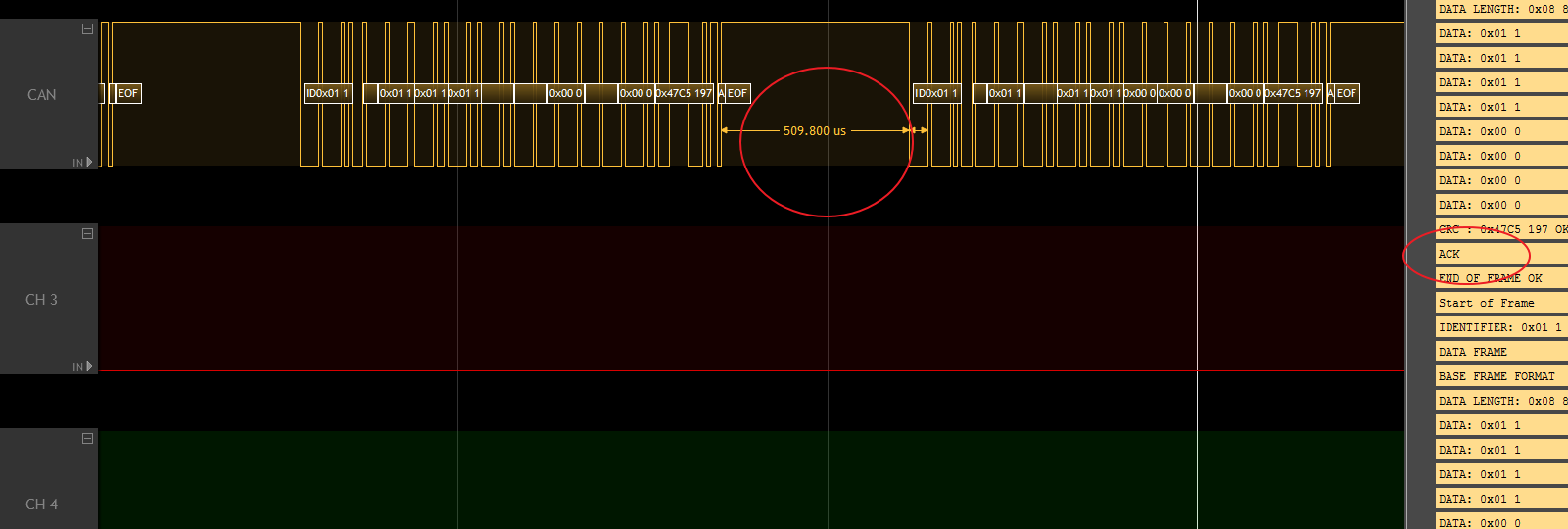

We have custom developed board with TM4C1294NCPDT MCU and SN65HV CAN Bus Transiever. It seems the CAN Message is continuously sending CAN messages when starts the CAN Bus communication for the first time, sometimes every 500us/ 1.5ms.  What could be the reason for this?  Here the Node is acknowledging the data, Hence not a bad node issue.
Could See the TXOK bit of CTL_STS is always high and the message is Acknowledged by the second Node(PFA images). Even being able to get the correct data in the second node.

    Is CAN SN65HV set in standby mode? standby (pin 8) 10k++ into GPIO port control? That make HD65 wait listen for RXD data on bus prior to send any TXD out.

  • HI this one is having slope control on 8th pin , and is connected with 10K + resistor.
  • Another Observation is when i commented out the TX int Enable flasgs everything works as expected.
    // TxMessage.ui32Flags = MSG_OBJ_TX_INT_ENABLE;
    Anyidea what could went wrong ?
  • And is the GPIO pin 8 set high, SN65 in standby mode? Recall datasheet states pin 8 high (stdby mode) keeps TXD pin quiet from RXD bus noise causing false TDX events. Seemingly TXD function must also set pin 8 low prior to sending data.

  • Please Note : " (For loop is removed and tested without success)"
    Work as expected , ie CAN bus is not trasnsmitting continous messages but Sending only when send function is called.
    its something related to TX INT Flag , When i enable this flag, message is sending continously. and "TX OBJ INT" log is continously printed in the console.

  • Pin 8 is pull down to Gnd with 10K , Now tried by pulling directly to Gnd without success , i will tap the channel and see if there is any noise in the channels
