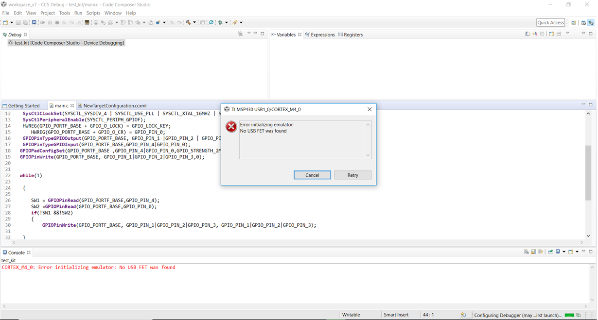

CCS/TM4C123GH6PM: Error initializing emulator: No USB FET was found
Part Number: TM4C123GH6PM
HI,
When I debug my project I get this error: Error initializing emulator: No USB FET was found. My version of CCS is v7 and I use kit Tiva C.
    I believe that is because you have selected an MSP430 USB FET emulator as your choice of emulation tool which wouldn't work for a TM4C LaunchPad. Is from a custom project? If so, reference our TivaWare example projects to see how to properly set the emulation configuration for your LaunchPad.
