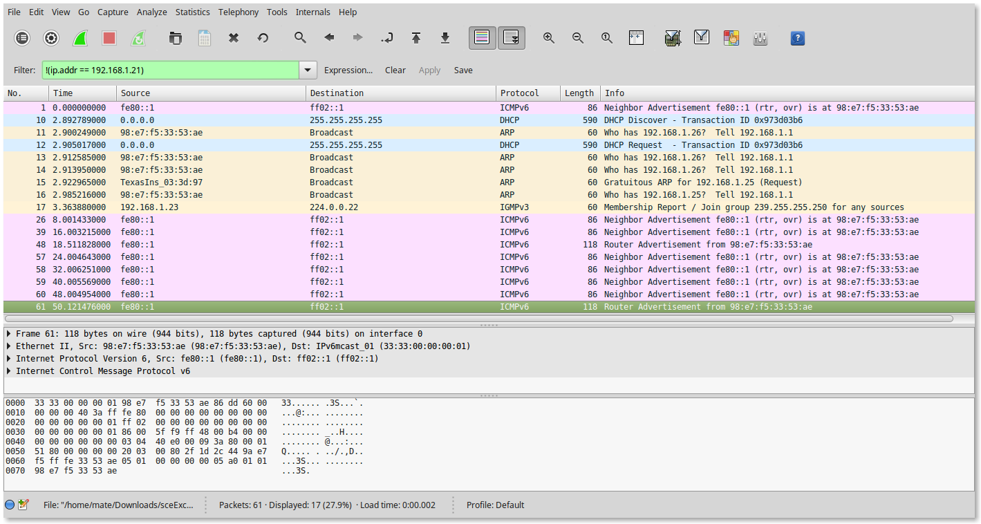

  • Hi Ramsey,
    I'm using
    Kernel         : Linux 3.16.0-5-amd64 (x86_64)
    Compiled    : #1 SMP Debian 3.16.51-3+deb8u1 (2018-01-08)
    Distribution : LMDE 2 Betsy
    and a Fritz!box Router for DHCP.   I've captured all traffic on the network with WireShark. But didn't find a way how to attach the output file. Please advice.
    Here is a screen copy of the last packets:
    At the 61st packet the exception occurs.   Claus
  • Well, I've managed to get ion at least a screenshot of the Wireshark output. I still don't see a way how to attach the complete *.pcapng. If helpful, please let me know, where to send it.
    Best regards Claus
  • Claus,
    Many thanks for your continued debugging effort. The Wireshark screen capture above indicates a possible issue in the NDK when receiving an IPv6 route advertisement. We indeed have a bug on file which might be related. It would be good to have the capture file to confirm this.
    Files are attached to a post. Please start a new post by clicking the Reply button. If you enter the basic text widget, click on the 'Insert Code, Attach Files and more...' link (lower right corner). This will take you to the advanced text editor. Look on the toolbar for the paper clip. Click the paper clip to open a new dialog. Click the browse button to select the file for uploading.
    Also, would you confirm the MAC address on which the NDK stack is running. It looks like TexasIns_03:3d:97.
    ~Ramsey

  • Claus,
    Thank you for attaching the Wireshark data file. This helped us confirm the issue you are seeing. We have filed a report and passed it on to the development team for resolution.
    ~Ramsey
  • Claus,
    Please view this post regarding a fix for the same issue you are experiencing. The error occurs because of a null pointer dereference in the function LLI6IsRouterStatMachine(). The fix is to check for a null pointer in Rt6Update() before calling LLI6Update() which will ultimately run into the error above.
    It might be while before an official release is rolled out for this part, so I recommend fixing it yourself using the post as a reference. I think this should resolve the error you are seeing.
    ~Ramsey
