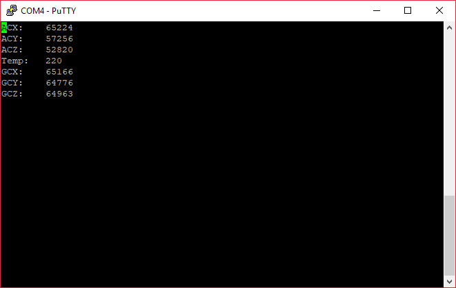

Hello folks,
I'm trying to read the sensor values from the MPU6050 module, but sometimes the code hangs (forcing me to power cycle the Tiva, reseting is futile) or reads wrong values (appears to be consistent, but not what it should be).

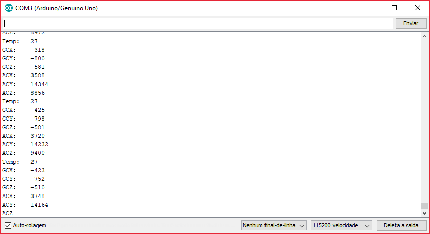

I've already tried using Arduino and the sensor works perfectly with the Uno. I've also interfaced the sensor with an ATmega328P on a breadboard using 3V3 to see if it's the voltage that was causing the problem, but it worked there also. So no problems working with 3V3.
Since the sensorlib poorly explains how to read from MPU6050 (not trying to be mean here, but there are problems including the files, adapting the I²C code to use the I2CM, etc), I've decided to make the readings myself using the I²C the "traditional way", reading/writing from/to registers manually.
Here is my code:

The steps I took to make the readings on the MPU6050:
- Initialized the GPIO, I²C and UART
- Initialized the I²C master writing mode 400kbps
- Initialized the MPU writing 0x00 to register 0x6B
- Sent write request to address 0x3B
- Changed I²C to read mode
- Read the registers and place the contents to the variables
- Merged the variables making 16bitvariable = 8bitvariable_H << 8 | 8bitvariable_L
- Calculated the temperature according to equation shown on MPU's register map page 30
- Printed the variables
- Changed the I²C to write, send write request to address 0x3B and do the readings all over again
Things that decreased the hangups: changed the way I was reading the variables. Instead of shifting 8 bits left on the "H" registers later in the code, I did it right in the I2CMasterDataGet() call. It only hangs occasionally when I don't insert a delay in the loop.
Output on Arduino:
Output on Tiva:
What's causing this strange behavior?
