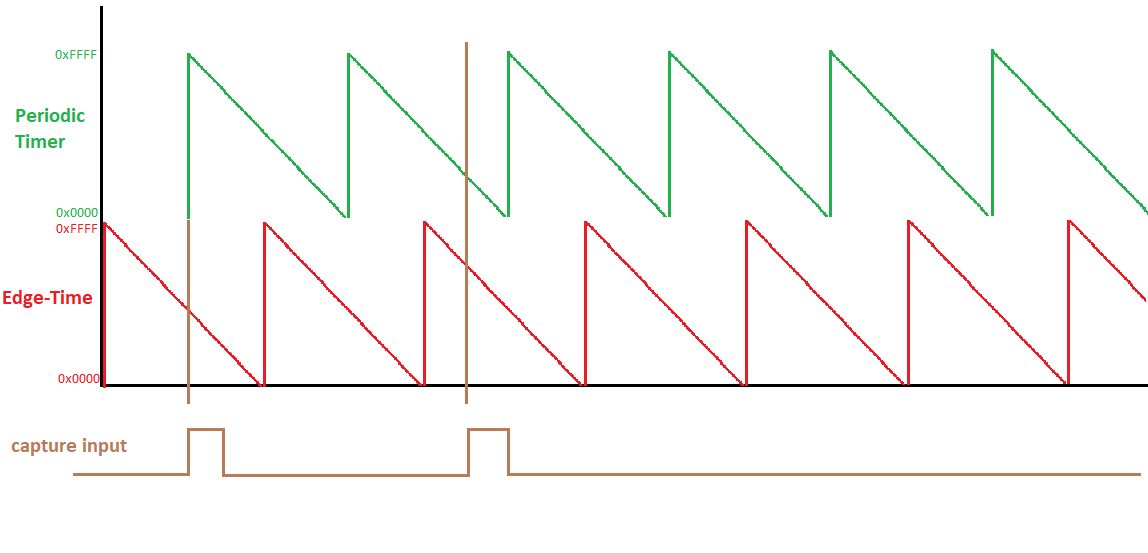

    Sorry but I still question how the periodic timer catches a missing edge, please advice which image below best represents how the two timers would interact.
    Image 1
    Image 2
    Image 3
    Thank you again,
    Fil

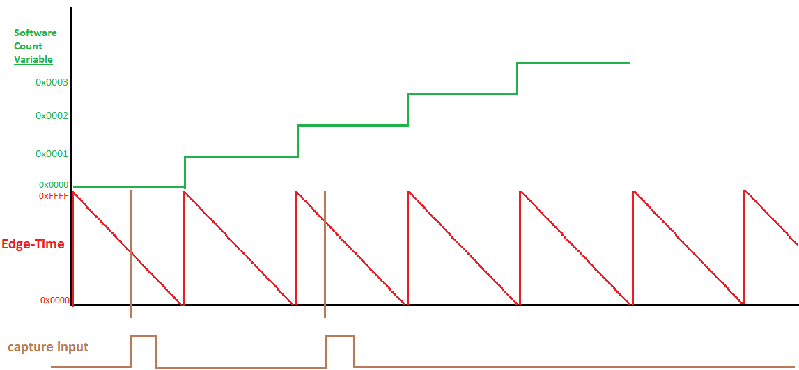

  • Thank you Danny.
    I get what you mean by counting every overflow like the image below. I am just curious about the method the datasheet it describing.
    Count by variable
    Fil
  • Filmon Elias said:
    I still question how the periodic timer catches a missing edge, please advice which image below ...
    I prefer "not" to be drawn into your scope of how such issue should be addressed.
    I have stated - and will do so again - "Should the Periodic Timer generate its interrupt - that indicates that the,  "Expected Signal Edge" has not arrived in a timely fashion."     And - it is my belief that the Edge Timer may well "increment" as it "reloads" and launches another count sequence.
    If the issue is language - maybe I'll defer to your diagrams.    I prepare "Technical Contracts" as one aspect of my job - and such "drawings" prove not as "clear/convincing" as the written word!
