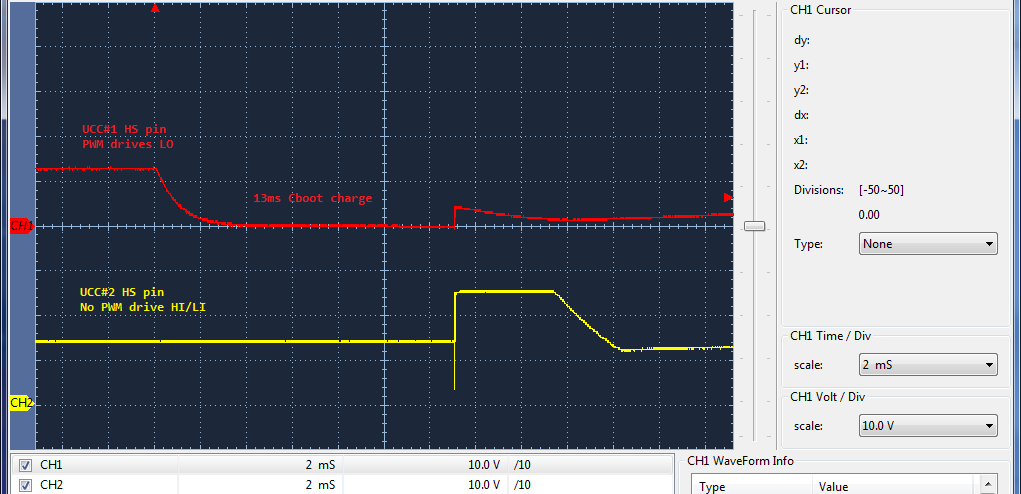

We have been trying to track down how PWM generator pulse periods seem to occur (phantom) on GPIO peripheral pins, when not being instructed by the application. Often these phantom peanut butter pulses are mirror copies of intended chocolate pulses application sent via PWM peripheral configured GPIO pins. The PWM pins action results are being monitored via ANIx channels and Special Analog inputs of the MCU. Peanut butter pulses (sticky) can oddly end up inverted below ground or as a single rouge phantom pulse thus triggering an external device to drive a damaging pulse.  Other TI forum gurus can not understand how such a damaging pulse can occur if the application did not instruct the pulse to be created. Otherwords the peanut butter pulses cause unclassified eratta in the chocolate driven external IC device.
The evidence of GPIO pin isolation barrier break down is indicated via numerous scope captures. All evidence of barrier break down seems contrary to REG 21 claim that the barrier should be disabled rather than enabled for ANIx pins. Alternatively for special analog device inputs in table 10-2, why would they be any different than ANIx pins?

  • Our sources have resolved that high voltage is being generated by the UCC27714 gate driver behavior toward MCU generated PWM pulse widths. If the MCU application allows the magnitude to grow unconstrained the MUC will POR when the magnitude reaches a certain trip point. That is how TM4C1294KCPDT analog I/O pad barrier is being corrupted, not from PCB design.
    Ideally a proven application successfully working via other vendors gate drivers should not have to be the baby sitter of TI gate drivers. Nor should anyone ever have to do an application rewrite as a work around for oddly preforming gate drivers. Seemingly vendors should try to keep consistent gate driver characteristics uniform for MCU driven PWM signals and not attempt to restrict basic industry accepted PWM signal behavior for what ever the reasons.
    Below you will see how PWM inverter voltage gain cause the analog barrier trip point to occur. Capture show MCU driven PWM pulse width corruption via UCC27714 gate drivers HI/LI inputs being restricted >100ns pulse widths. If you have an easy WA for this behavior please post duty cycle update function that can produce slow decay inverter current without producing a PWM pulse width <100ns. So far all attempts have been futile and painfully driven on our part, hundreds of unexpected candle hours burning to make such work via UCC27714 drivers.

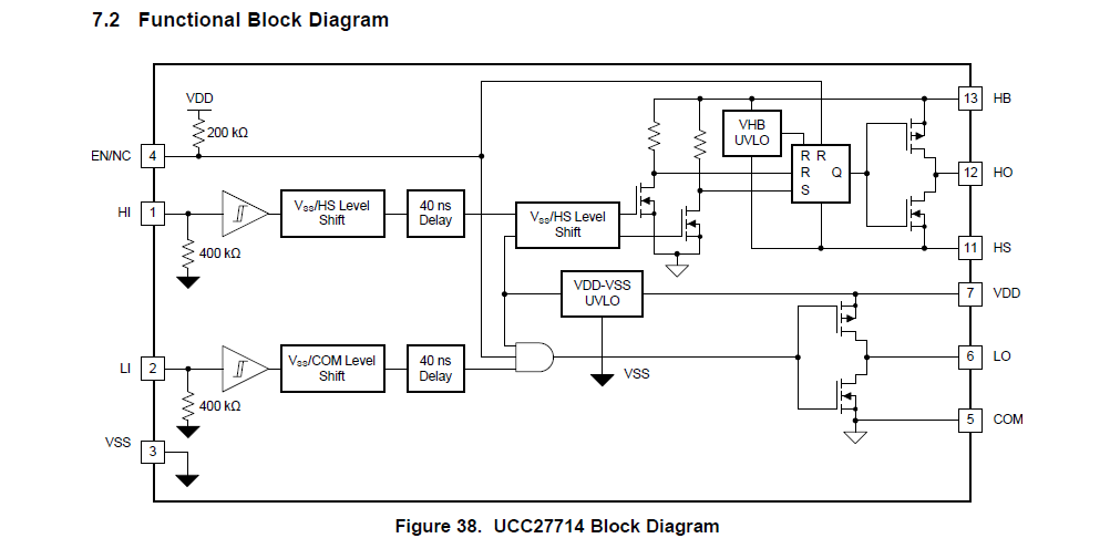

  • BTW have discovered TI engineer may have reversed two pins UCC27714 gate driver (HS/HB) in datasheet or has incorrectly drawn HO driver Totem pole PFET top, should exist bottom where NFET is drawn. If Q' were driving HO it would not matter but it is not drawn that way, power device forum Derek also made notice but said it may be incorrectly drawn.
    Why is that important, for one the high side RS latch shows Q not Q' relative to typical industry designs well before TI ever developed any such gate drivers. Hence the PWM generators outputs seemingly must be inverted to compensate for this TI design error.
    Only a lunatic would ever consider inverting PWM signals in high voltage PWM input signals as typical designs avoid inverted PWM like the black plague.

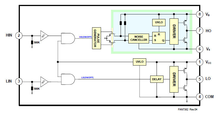

  • Typical industry gate driver has High side PFET on Totem pole bottom, not PFET on top or uses Q' to drive Totem pole if driver FETS are reversed.  Trouble shooting difficult issues is often a process of elimination of the most obvious being first, less obvious later as human awareness takes over. So UCC27714 VB or HB would be VS but is HB instead relative to HI/LI PWM signals. That is of course if the UCC27714 was drawn incorrectly as it was earlier expressed Q should have been Q' in drawing but seems more bamboozling is in play.
  • The top gate driver above post is proven to work with TM4C1294 PWM and not POR the MCU when PWM durty cycle is near 1% or pulse width falls below 100ns.
    Not one word in UCC27714 datasheet that it differs from industry standard PWM signals and may require INVERTED PWM signals to drive HI/LI inputs.
    So we are not to far off in this thread when saying PWM peripheral signals seem to cause negative PWM Ghosts on the analog I/O pad barrier into MCU digital realm.
