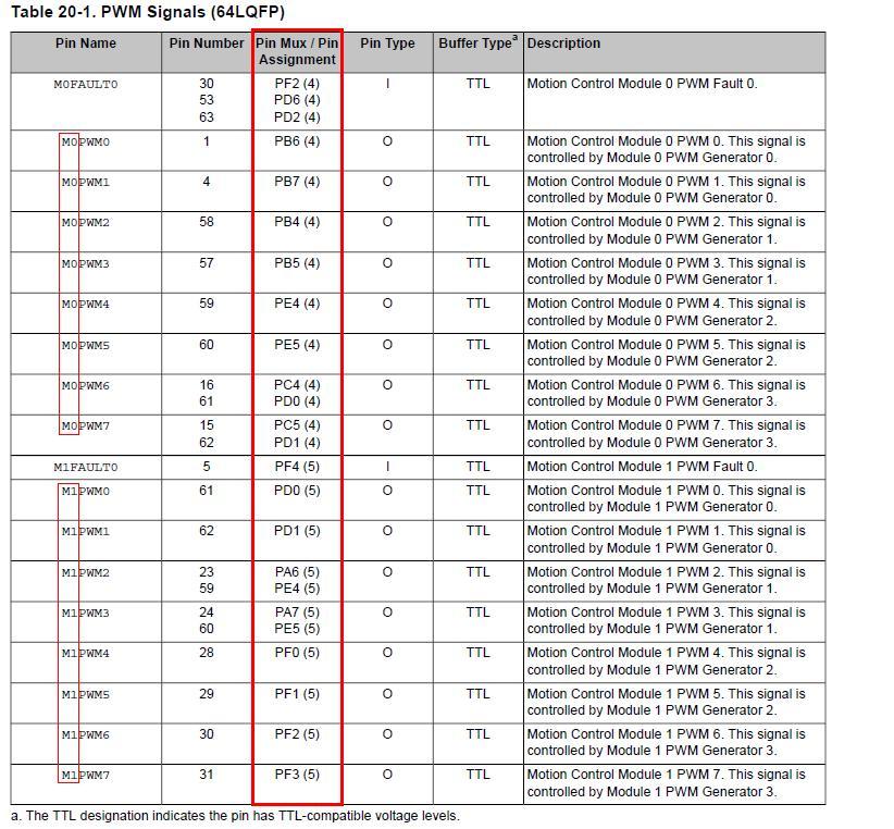

    Absolutely - obtaining PWM Output - from those pins "falling w/in the MCU's listing of  "PWM Capable" - AND which are "brought out to header pins (on the LPad)  surely  can be  accommodated!
    Presented (here) as (another) "Cb1 Public Service" (in satisfaction of  "Work Release" status) is the Listing of  "ALL (legal) Candidate PWM pins:"
    Note the (colored) highlights: ONLY those pins - listed w/in column 3 - are equipped w/"in-built" PWM functionality.    (Timer pins may be programmed to provide "lesser"  PWM competency.)
    Poster must carefully compare/contrast,  "His/Her chosen pins to insure a "match" to this  "defining/regulating"  chart.
    Note too - the left-most column - which reveals the division of such PWM-Capable pins - into usually (but not always) a  Single PWM Module.   (there are two such modules - denoted as M0 & M1.)   Certain pins (albeit only a few) exhibit "dual citizenship" - able to reside w/in "either" PWM Module.    (yet only "active" - w/in one module - at a time...)   PD0, PD1, PF2 are (some) - but not all - such "dual" pins.
    *** Returning to poster's specifics - it must be that,  "One or more of the required,  "Set-Up/Config. Functions" were "missed" - or applied incorrectly.    (they ARE - rather detailed)    Note that a "competent investigator" picks up on poster's use of  "PCTL table, on the datasheet" - which (likely) suggests that poster employed the (dreaded) "DRM" - thus his "FAILED PROGRAM" - is unfortunately - "To be Expected!"    Poster's hapless "Helper Crüe" - deprived of ANY Code extract to analyze - is left then  ONLY  with this advice option - to poster:
