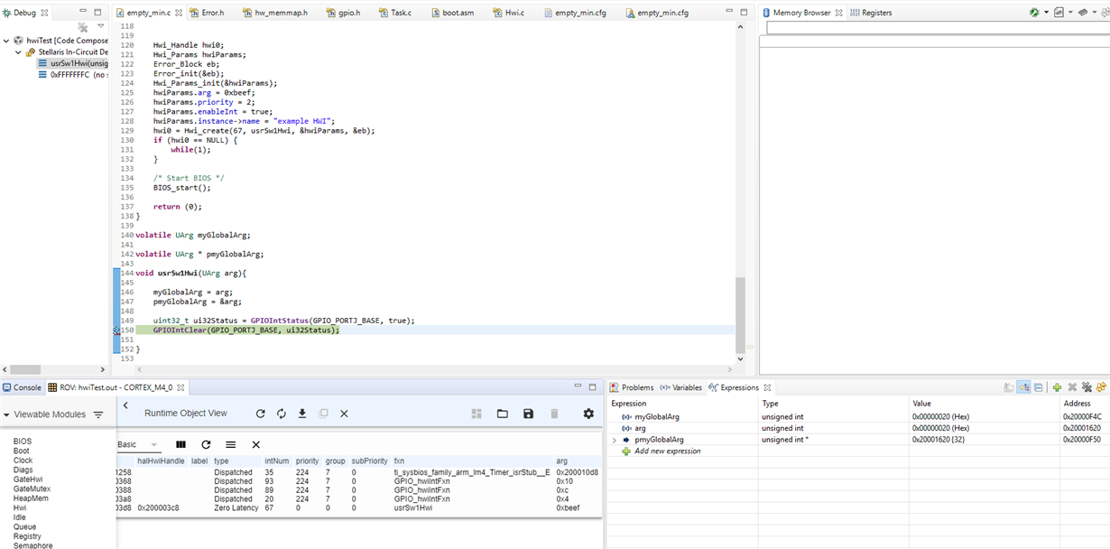

The ROV agrees with the .cfg file as to what arg should be, but the same screenshot shows that the value given is not what I expect:

  • Hi Peter,
    Can you use the arg in the function and see if that changes things. Maybe just have a volatile global variable that gets assigned the value of arg in the Hwi function.
    volatile UArg myGlobalArg;
    void IPButtonISR(UArg arg)
       myGlobalArg = arg;
    Depending on your optimization settings, sometimes the compiler does tricks that CCS Variable windows does not understand. The arg value in ROV is being pulled out of the Hwi_Object.
    Might be good to do a quick ROV->BIOS->Scan for Errors also to run out any funny business like blown stacks also.
    Why aren't you seeing this behavior with the runtime created Hwi...not sure. Maybe different optimization levels.
    Todd

  • Todd,
    I followed your debug steps. This is a good idea to verify the expressions window, and everything checks out. The file is attached. The project has a relative link to my driberlib.lib.
    I recreated the error on the EK-TM4C1294XL dev kit from the empty (minimal) project template because I do not access to the exact code from above from home. Press the usr sw1 button to trigger the hwi. Change the priority to -1 to get 0xBEEF.
     hwi_arg_error.zip
  • Hi Peter,
    Thanks for the example. The issue is that the Hwi you are creating is a zero-latency interrupt (kernel does not manage it so it add zero-latency). This is due to the hwiParams.priority = 2. Two is less than Hwi.disablePriority (which is 32 for TM4C). So the kernel leaves the ISR alone. So when it fires, the CPU directly calls your function as opposed to going through the kernel's stub. The kernel's stub does the following high-level things

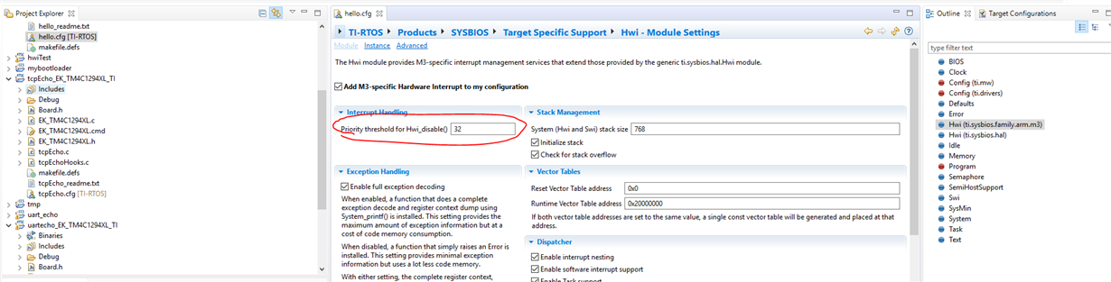

    I misspoke above. All example projects I download from the resource explorer have the priority threshold set to 32. This field shows NULL before the actual value is loaded. The value in this field becomes Hwi.disablePriority when looking at the .cfg file as raw text. This field is what I changed to get successful HWI arguments with various priorities.
    However! Hwi.disablePriority  does not show up in the raw text at all until is it changed from its default value. If you change it from 32 to something else, and then back to 32, it remains.
    Here is a screenshot for clarification:
  • Peter,
    Thanks for the clarification. It should show 32 (which is the default) in both the red circle in your pic and in the Advanced tab in XGCONF also. In regards to the .cfg when viewed as a text file....we have lots (and some could argue too many) configuration settings. The vast majority have default values, so if it not explicitly set in the .cfg file, it assumes the default. What the graphical view is showing is those explicitly set values and the defaults values for ones that are not explicitly set.
    So when you change a default value and change it back in the graphical tool, it is stored in the .cfg explicitly.
    In general we try to include the common configuration parameters in the .cfg explicitly even if the value we are using is the default. This is to help the people that edit the .cfg as a text file instead of the graphical tool. I personally only use the graphical tool when I forgot the exact name or syntax of a configuration parameter.
