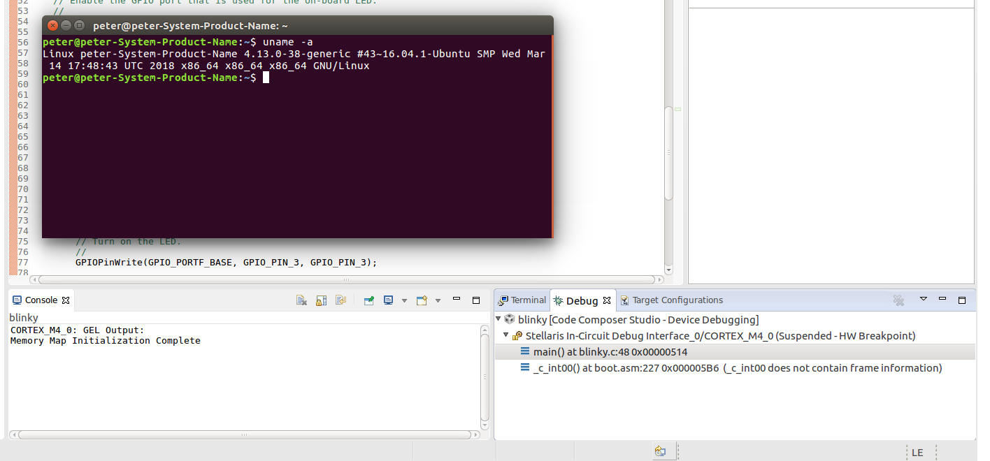

  • The linux install should come with a bash script to install the drivers. You have to run this in addition to the IDE install.
    http://processors.wiki.ti.com/index.php/Linux_Host_Support_CCSv7
    To cb1's point on digging, if you search "ubuntu launchpad", my struggles are the top hit.
  • May it be asked - are you offering this, "Bash script install" as "Counter to Vendor Rep's earlier noting:"
    "I don't see Linux support of the Stellaris ICDI used on the EK-TM4C123GXL. "
    Have you "succeeded" in such an installation?
  • I have succeeded, and I faintly recall some issue with the MSP430 launchpad, but the TM4C dev kits work

  • Sorry, I wasn't able to look into this yesterday.
    I have run those Linux scripts. From what I can tell they just install udev rules which allow you to access the board as as non-super user. I still can't access, sudo or not..

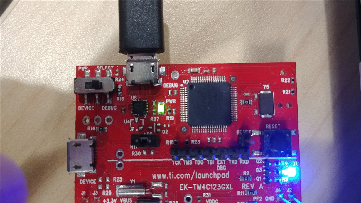

    I confirm what Peter has shown above - I can connect to my EK-TM4C123GXL board without issues on CCSv8.0.0 on Ubuntu 18.04 with all udev rules properly set - you should have the file /etc/udev/rules.d/71-ti-permissions-rules with read permissions for all users (sometimes updates to udev rules only are effective after a reboot). Also, lsusb should show a device 1cbe:00fd
    One additional detail: make sure the switches, jumpers and cable are connected as below (apologize for the bad photograph):
    Hope this helps,
    Rafael
