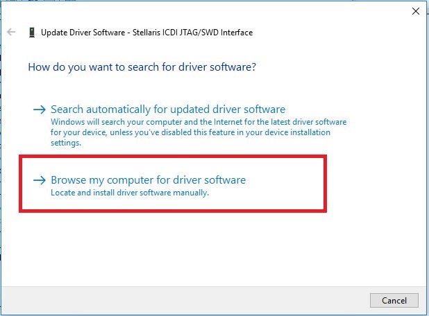

I received the launchpad last week from Mouser Electronics. I first installed the Keil IDE and connected the device's debug USB port to my Windows 10 laptop, but I received the following notification:
Moving to Windows Device Manager, I notice that the device is not recognized (device descriptor failed).
I installed the Stellaris drivers manually from TI's website, but that did not change the situation.
I then tried with the other ports of my laptop, with the same result. I tried with my desktop computer (also a Windows 10 system) and had the same result.
I then resorted to more advanced solutions, such as found on this website:
But none of these attempts could remove the error. The Keil IDE doesn't find the device either when I attempt to download code.
I am coming down to the conclusion that the drivers are broken, rendering useless the TI T4MC123G device I purchased.
Do you have any solution for this problem I may have overlooked?

    Latest driver from the second link displays the same behavior. If I update the unknown device from Windows Device Manager and load the new driver, Windows says that the best available driver for this device is already installed. Manually installing the driver from boot_usb.inf doesn't change anything either.

    The latest drivers are not broken for Windows 10, we have hundreds of Win 10 users using them without issue (there was some signing problem a while back when it first came out, but those have long been resolved. I myself have a Windows 10 laptop and I have not had any issues with the latest drivers. Either the LaunchPad is the issue (occasional DOA happens) or there is a missing step.
    When you install the drivers, are you doing a manual installation by browsing for driver software directing Windows the download folder for the driver?
    Can you try to uninstall the driver that Windows automatically downloaded for it, and then try with a manual process?
    Lastly, you mention you plugged the USB cable into the debug port, have you
    1) Ensured the switch next to the port is set to "Debug"
    2) Tried a new USB Cable?
    I ask #2 because you'd be surprised how many times issues like this end up being due to the USB cable... so please do give that a try as well.
  • The small USB adapter packaged with my Launch Pad causes this issue. Switching to a USB adapter of my own, I immediately noticed the appearance of the 3 USB devices (ICDI JTAG and such) in the Device Manager.
    Using the latest drivers (second link) to update the drivers would not do it, leaving them with the warning. However, the website drivers worked and I could debug the device with Keil.
