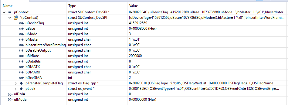

    Device A is running at 2000000 bps, mode 3, 8 bits. Device B is running at 500000 bps, mode 0, 16 bits. The SS lines are controlled manually via GPIO toggles.
    The same code is used to configure both devices. A context structure is passed to the function to specify what configuration is desired:

    The values of the variables are as follows:

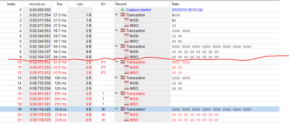

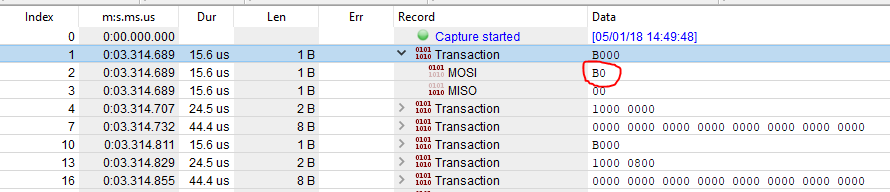

    Here is the SPI sniffer trace for a good transaction:

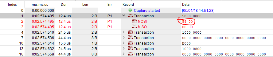

    Here is the trace for a bad one:

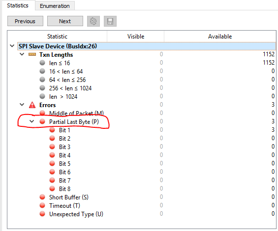

    And here is the error report for the bad transaction:

    Here is the SPI sniffer trace. Above the (wavy) red line is the first write to device A. Below the line is the second write. (I cannot capture both devices at the same time, since the sniffer only has one CS line to monitor.)
    As you can see, the first time the 0xB0 is sent properly. The second time 0x58, 0x00 is sent instead. But as far as I can tell, the SSI configuration for both sessions is identical.
