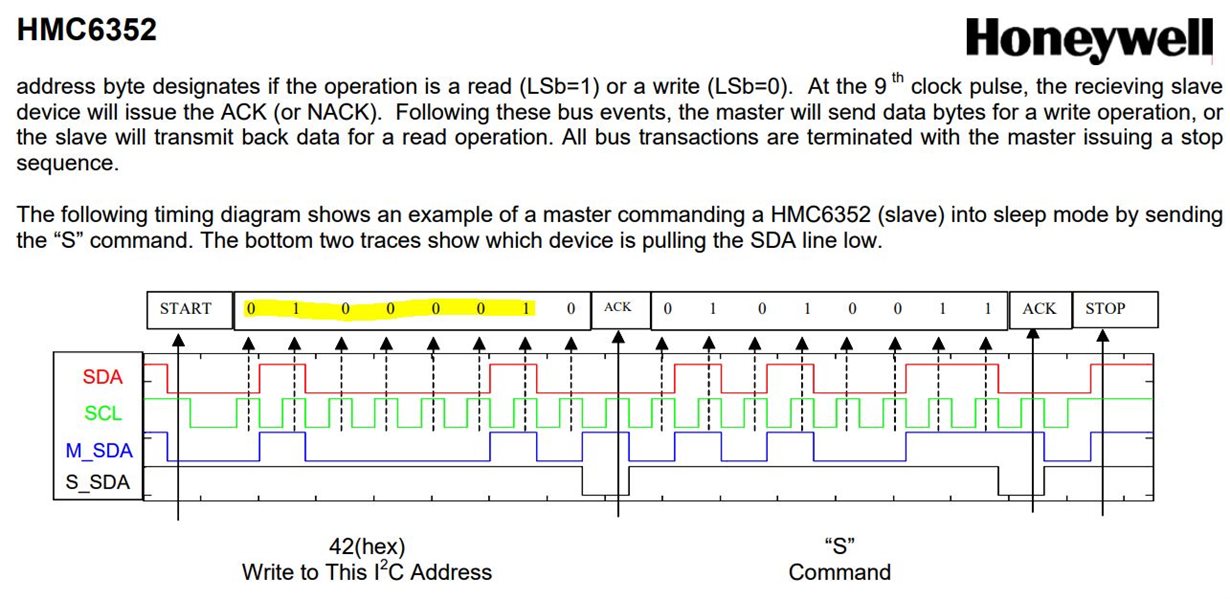

Part Number: TM4C1233H6PM
I've ran the I2C loopback example in the tivaware folder and taken what I could from that to try and set up communication with
a rather old compass sensor part HMC6352.
It works fine with an arduino sketch but I can't get it working with the tivaware. Here is my code. Have I missed or mistaken something?
Slave address for this device is 0x42 for write and 0x43 for read. I think this is taken care of with the true and false condition in the set slave address function.
The device is supposed to operate at 100kbps mode but not sure what the default is set for in the driverlib I2c.

I2CMasterSlaveAddrSet(I2C0_BASE, SLAVE_ADDRESS, false);
