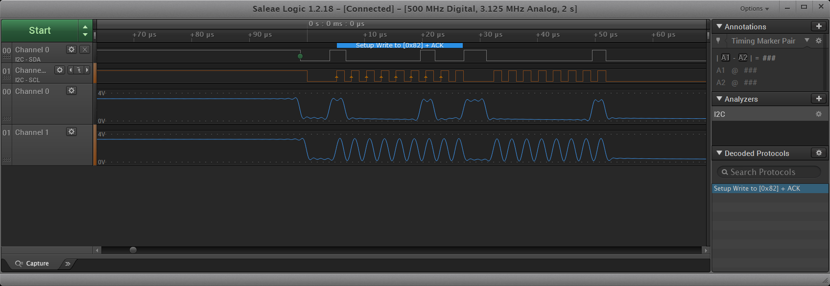

I'm trying to implement an I2C Slave on I2C7, but I'm not getting the expected interrupts, and no ACK is generated for data bytes.
I'm stuck and don't find the cause. I know mixing RTOS and Driverlib is not the best way to do but I haven't found anything suitable in the RTOS abstraction layer.

Logic Analyzer Output:

    I agree with Peter to first try without TI-RTOS. It will be easier to debug your code if you want to mix TivaWare with TI-RTOS's Hwi managing the interrupts. Please note that TI-RTOS has its own drivers to support I2C as well if you want to use it. With that much said, I notice in your capture the slave address sent by the master is 0x82 while you set your slave address to 0x41 in the code.
    Please also make sure two things in your code. First, please make sure INT_I2C7 is the correct interrupt channel number for I2C7. Second, please make sure the handle returned by Hwi_create is not NULL. You should test if the handle is NULL or not before proceeding.
  • 0x41 is the 7 bit I2C address, 0x82 is the 8 bit address with a 0 write bit appended. This seems to work correctly, otherwise I wouldn't get an ACK after the first byte.

  • Problem solved.
    You must do I2CSlaveEnable() before I2CSlaveIntEnableEx(), otherwise the Interrupt Enable bits wouldn't be set.
