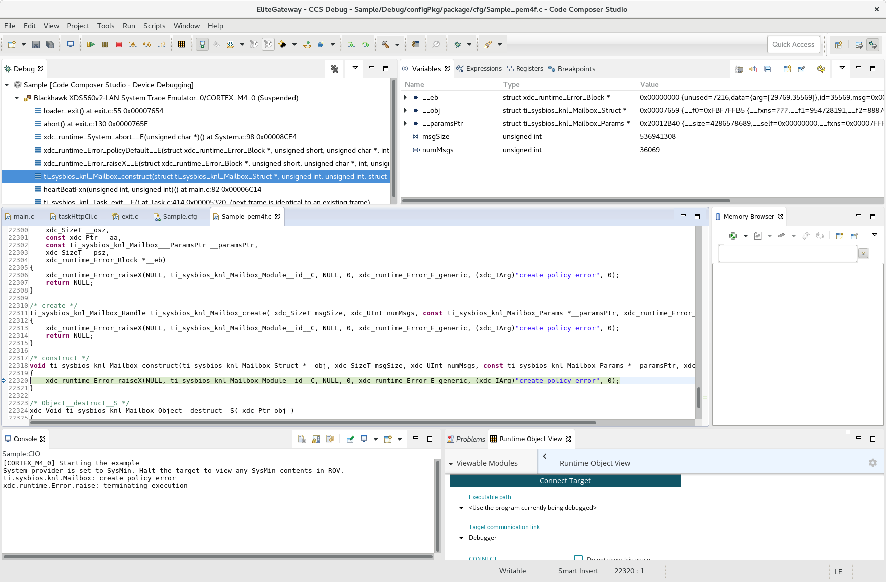

  • Sorry to be slow getting back with you.  I had other work to do.  However, today I put together a project that shows the problem.
    I am using TI-RTOS for TivaC 2.16.0.08
    5775.Sample.zip
  • In the original posting the problem arose with the GateMutex_construct call.  The Sample application triggers the same basic problem but it is using the Mailbox_construct call.  The screenshot below shows the problem in the debugger.

  • Hi Roy,
    Thanks for the example. After looking at it, I realized I made a mistake when trying to reproduce it. I can now.
    Each of the modules in TI-RTOS (actually SYS/BIOS and XDCtools) have a way to describe certain aspects of the module in their .xdc files. I won't go into the details, but the short story is if the module has @InstanceInitStatic in their .xdc file, then the construct can be called if BIOS.runtimeCreatesEnabled = false; (or more specifically if module's creation policy is static). Both Mailbox and GateMutex do not have @InstanceInitStatic in their .xdc file (and thus the error in the generated code).
    So why would you leave out @InstanceInitStatic for a module? If the construct is going to allocate mmory, it should not be called. Looking at both Mailbox and GateMutex, the construct does not require memory allocation. We've actually added @InstanceInitStatic into Mailbox.xdc in newer releases. We should add it into GateMutex also (and should re-evaluate all modules).
