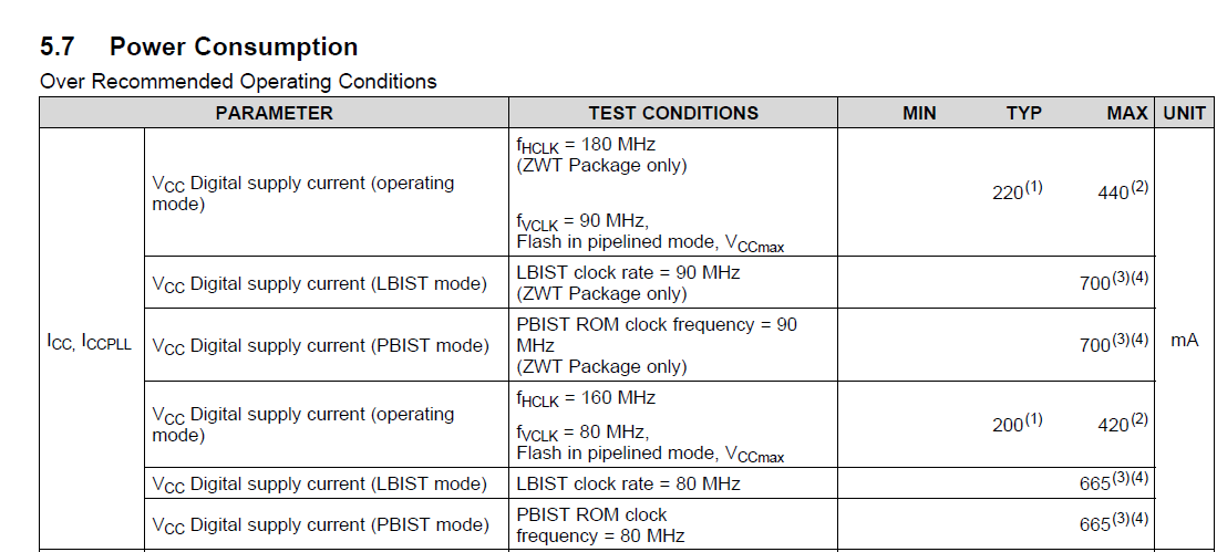

For TPS65381 the VDD1 maximum output current is 600mA, but the LS3137 VCC in LBIST or PBIST mode maximum VCC current is 700mA,
So that means TPS65381 not suitable for LS3137?
Any other suitable PMIIC can working with LS3137?
