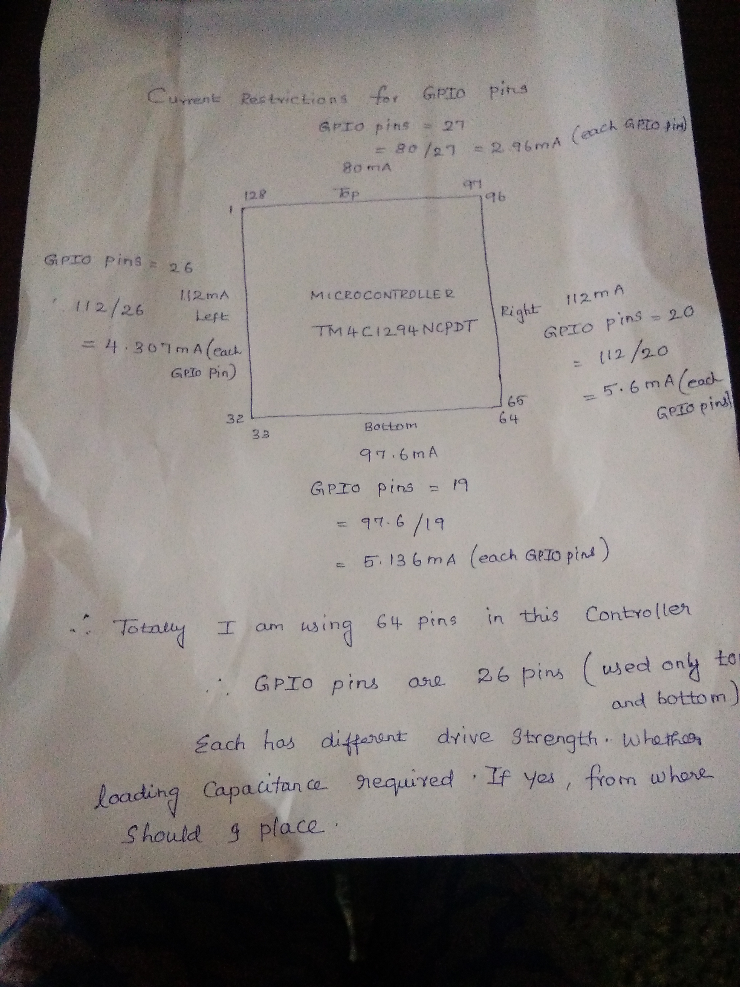

I am going to design a power circuit to my board. I have gone through the data sheet about current restriction. They specifically mentioned for each side of cumulative current for GPIO pins. In TM4C1294NCPDT datasheet,  page no. 1822 mentioned about the I/O reliability and page no. 1823 mention the load condition for the GPIO pin. I couldn't understand, for which pin i need to add the capacitive loading.

  • Hi Sir
    Thanks for your information.I have a doubt,  I am enclosing the picture whether i am calculated current consumption is right or wrong. I have referred TM4C1294NCPDT datasheet page no.1821 & 1822. Kindly help me from where this capacitive load value 50pf to be place.
    I have another doubt, i have calculated the current consumption for micro controller based on page no 1880. I have calculated only Irun, Isleep, I deepsleep for 120Mhz at 85 degree Celsius for condition only Vdd,Vdda and peripherals=all ON including MAC and  PHY whether it is right or wrong?? I am going right path....

    The 50pF loading mentioned in the datasheet means that the assumptions about the I/O reliability is based on using a 50pF load. It is not that the datasheet is asking you to place 50pF load on every GPIO pin. As I mentioned, the amount of load on each pin depends on the device you place on the pin. It may be smaller than 50pF. You need to check the datasheet of your external device.
    Also note that in table 27-9 the GPIO current restriction data is based on design simulations, not tested in production. Can you voltage regulator supply the required amount of current?
    Please also refer to the TM4C123 system design guideline on the GPIO section in page 41.
