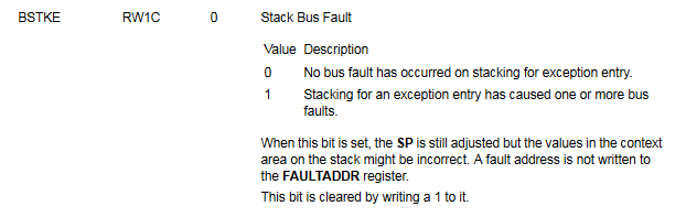

Hi there,
I'm working with the DK-TM4C129X. For a simple IO tester i would like to write on the Display the name of the signal under Test.
So I defined a const char* array of the signal names and a counter, which indicates, which signal is under test.
If I try to debug the software, the MCU crashed during the FrameDraw function und stuck in the FaultISR routine.
When I replace sig[counter] with sig[8] or sig[0] in the GrStringDrawCentered function, it will work. Of course just printing always the same string.
Thanks for the Answer
Benjamin
