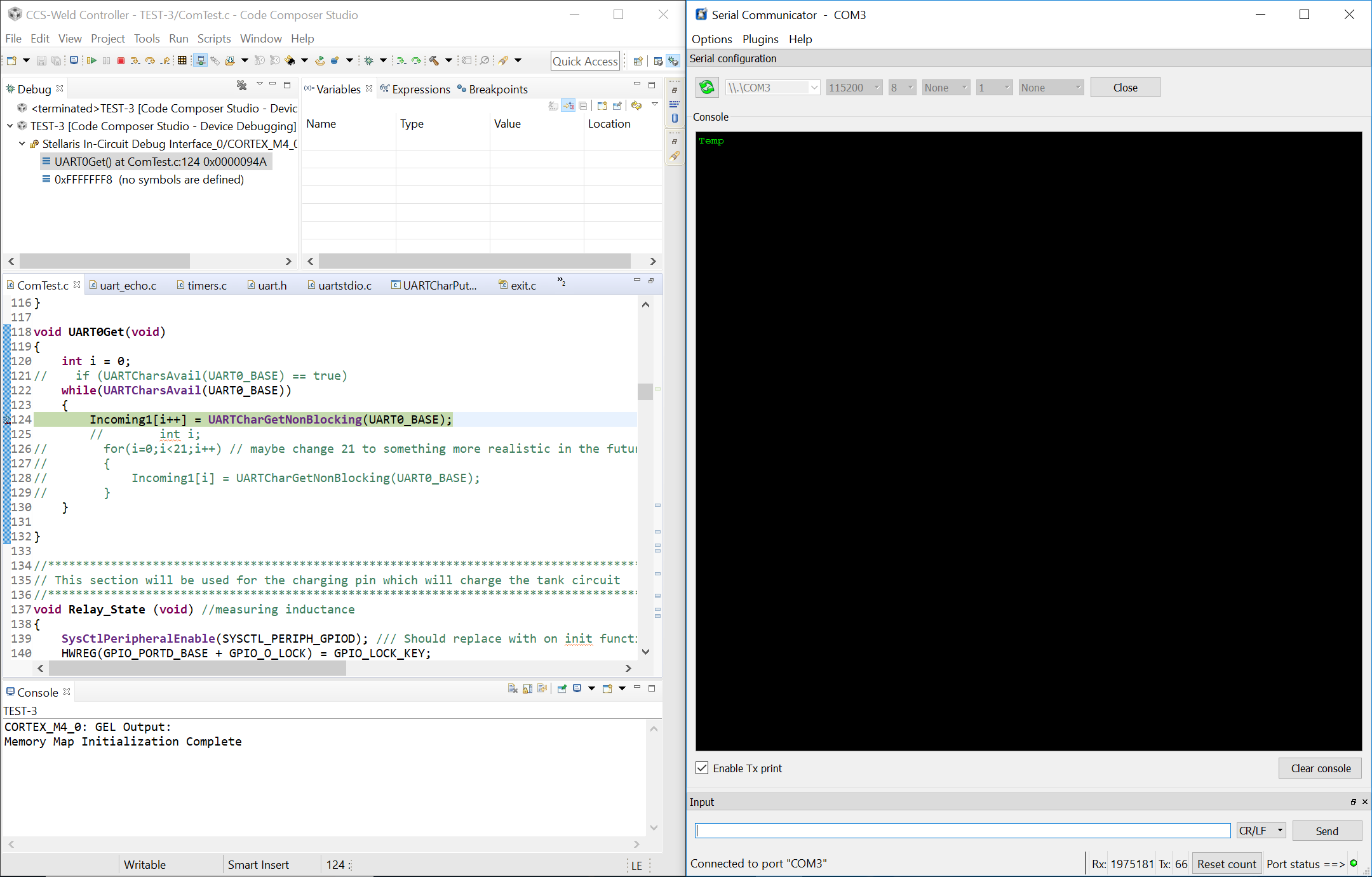

  • Hey Ralph, so I am trying to see the value of the buffer but I cant figure out where to find it. It is not in my variable location. I included a picture so you may see what I am seeing. I also played around with the buffer value and by the amount times I had to allow the breakpoint to resume there appears to be at least 2 terminating characters. I am not sure what they are. I did notice that once it goes through "Temp" is printed with a new line so I think there may be /n and something else but I am unsure what it could be.
    Could you please tell me how I can observe what is going into my buffer?
    I know I am not using Putty, I only said putty because it is more popular than what I am using but I think they are the same. That "Temp" that appears in Serial Communicator is the one I typed in to initiate the interrupt.
  • Hello Hisham,
    That is not what I had meant, I mean using the Expressions view in CCS to view the variable straight out of memory which leverages the debugging capability of CCS and JTAG. You can search for "Expressions View" in CCS help for more details about it.
    It can be brought up by going to the "View" menu and selecting Expressions, and then you can add your buffer to it either by typing the name in, or by right clicking it and selecting "Add Watch Expression..."
    If you want to type the name in, you can see a simple demo here (ignore the breakpoint part): www.youtube.com/watch
    For setting a breakpoint given how your program is setup, you may need to place a flag in your ISR to indicate when you received data, and then you can break on the flag being set within your main code so when you send a message over UART you can immediate break to see what the data is in your buffer after reception.
