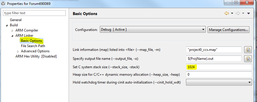

My process not run and jump to FaultISR() function of tm4c123gh6pm_startup_ccs.c file. Before debugging, I built and not have errors. So anyone can help me how to use sprintf() function.

  • Your problem has nothing to do with studio.h and everything to do with your code.
  • From your code it is not clear to me what you are trying to do. What your code does is tries to print the address of the variable "varX" as a decimal number into the three byte string temp. It won't fit. but the reason you are jumping to the FaultISR is that most likely you have overflowed the stack. The "sprintf" function requires a lot of stack space. The default project only allocates 256 bytes. Increase your stack size to 1024 bytes. You can do this by changing the project settings and editing the link command file.
    Changing the project settings:
    Editing the link command file:
    __STACK_TOP = __stack + 1024;
