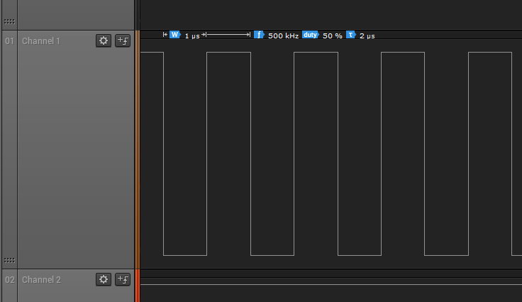

And configured the Timer0 to be the trigger (counting at 2MHz speed). But the ADC speed is capped at 1MHz, even when I use ADC_TRIGGER_ALWAYS instead. The system clock is 120MHz with 480MHz PLL.
I'm using these functions and a logic analyser to see the actual speed:
void ADC0SS3IntHandler(void)
    ROM_ADCIntClear(ADC0_BASE, 3);
    //ROM_ADCSequenceDataGet(ADC0_BASE, 3, g_adc0Reading);
    ROM_GPIOPinWrite(GPIO_PORTA_BASE, GPIO_PIN_4, g_flagAdc0 ? GPIO_PIN_4 : 0x00);
    g_flagAdc0 = !g_flagAdc0;
The ADC frequency is 2x the output pin frequency. The only way I could achieve a little higher than 1MSPS (~1.2MSPS unstable) was when I divided the PLL frequency by 7 (resulting a 68MHz for the ADC), but that doesn't make sense. What can I do to achieve 2MSPS?

  • Sorry, there is an issue with the documentation. The ADC converter clock is really PLL VCO divided by 2, then divided by the value in the CLKDIV field (CLKDIV+1)  of the ADCCC register. You cannot get 32MHz ADC clock running the PLL VCO at 480MHz, but running the PLL VCO at 320MHz, you can get 2MSPS by using divide by 5.
    The issue is further complicated by the fact that at 2MSPS there is not enough time to use TivaWare calls in the interrupt service routine to toggle a GPIO pin and clear the interrupt. (Much less, read and store the sample.) In the example below I replaced some TivaWare calls with direct register writes to avoid the overhead of the subroutine calls.

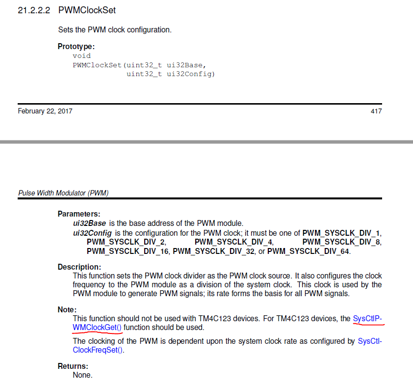

  • Now it is working, thank you Bob! I suspected that I would have to write the registers directly. But that's no problem, as I am going to use hardware oversampling (>=16).
    And, speaking of documentation issues, I found a small error in the TivaWare Peripheral Driver Library user's guide:
    I think it should be SysCtlPWMClockSet().
    Thanks again Bob for your help!
