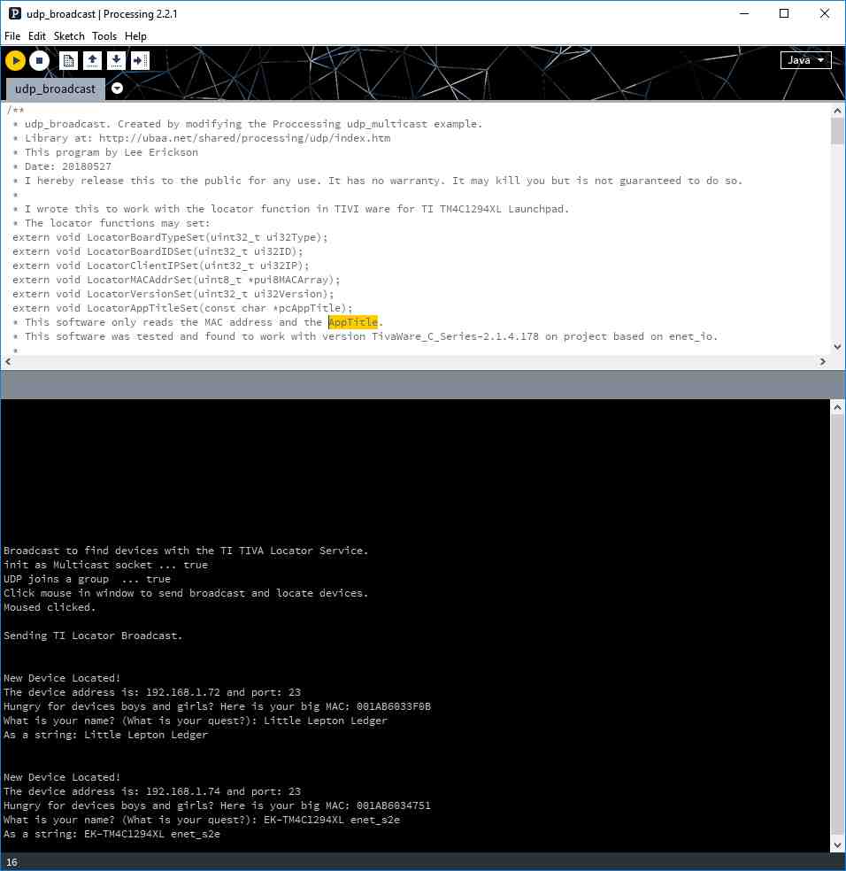

  • I created a program in Processing to send a UDP Broadcast and receive a unicast reply with the data from the Locator server on the TIVA.
    Here is a working version.
    I am putting some more polish on this and will upload to github when I figure out the upload process.

  • Screen shot of result of locating two TM4C1294XL devices on a network.
  • Hi Forrest,
    Glad that you got it working. Will you send the screenshot again? It is not view-able.

  • My Processing solution is now pushed to github.
    See: github.com/.../master
  • Thank you Forrest for sharing.
    The finder application is another tool to find the Tiva device on the network.
