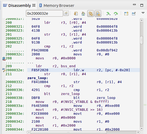

Breakpoints  within TI's flash based bootloader are initially overwritten. This makes debugging bootloader initialization code difficult.
The issue is caused by the function ProcessorInit in bl_startup_css.s. ProcessorInit has a copy loop that puts bootloader code from flash into SRAM. This allows the bootloader to erase and write to flash at will. The hardware FPB unit only places breakpoints in code memory. Breakpoints in SRAM code are implemented by modifying the the opcodes. The copy loop overwrites the SRAM breakpoint. You may notice the debugging session starts the PC at an SRAM address. This does not solve the problem as the copy loop itself is copied and runs. Everything in SRAM is written twice.
As a workaround, you can set a hardware watch point at the address shortly after the copy loop.  The disassembly window shows where the assembly code is placed in memory. In this example, the copy loop is followed by a movs at address 0x2000032C.
Setting a hardware watchpoint at 0x2000032E will break after this particular movs is copied into SRAM for a second time. After this second copy, you may place an SRAM breakpoint at  0x2000032C. Hitting this breakpoint indicates the copy loop is over, and you are free to place SRAM breakpoints elsewhere in the bootloader.

  • This was interesting. The copy loop doesn't actually need to happen twice at runtime, but the debugger complicates things by wanting to start at _c_init00. I see this happen; the debugger starts the PC at 0x200003A2. However running successfully should not be possible because the copy loop hasn't happened yet and the SRAM should not be initialized. My workaround shouldn't work.
    Mr Miles acknowledges this "So single-stepping from _c_int00() is not going to work". However, I can single step past _c_int00(). I do not understand why this works, and I don't expect it to. I assume CCS lets the chip run for a fraction of a second and the code that does the coping gets to run before the debugger starts the chip back at _c_int00().
