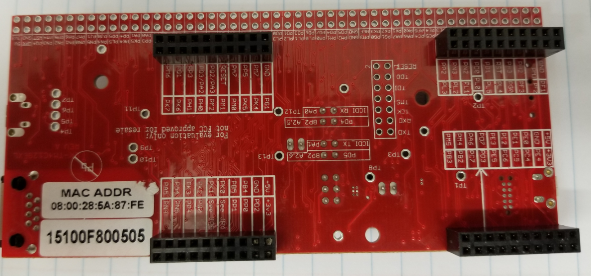

I purchased TM4C129ENCPDT MCU form Digikey. I didn't get MAC Address for the IC. Whether i need to get it or it will be included in package utself ?

If you do not have the sticker, another way to read the MAC address programmed into the part is to connect to the LM Flash Programmer utility. On the "Other Utilities" tab select "Get Current MAC Address".

I purchased IC alone, not evaluation Kit. For IC alone i didn't get any papers with it.
