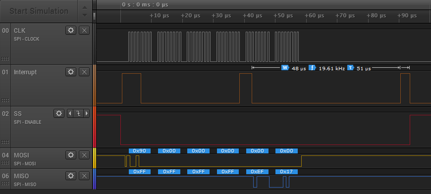

I will use an example to illustrate my problem, lets say when I want to read the device id and manufacturer id of the
winbond flash. The flash requires the master to send WB_READ_ID followed by 3 bytes of 0x00, then the flash will
spit out the device id + manufacturer id.
Below is a diagram to illustrate the transfer:
XX = don't care
    // Transmitting 4 data bytes and expects two bytes of device id + manufacturer id
    TX                                         RX
    WB_READ_ID                   XX
    0x00                                    XX
    0x00                                    XX
    0x00                                    XX
    // Master needs to drive clock to allow man_id and dev_id to be shifted out
    0x00                                    man_id
    0x00                                    dev_id

As one can see, according to the logic of my code, in this case, I should only enter the ISR two times. When
I step-debug my code(insert breakpoint in the ISR), I was able to see the program enter exactly twice. However,
when I do a full run, I get 3 ISR entries which is weird (I inserted a counter to keep the count of ISR entry, and I also
tried to toggle a gpio to monitor the entry / exit of ISR using logic analyzer).
Is there something that I am not understanding correctly about my code or the interrupt mechanism of cortex m4 ...etc?

  • Your logic analyzer image shows a good picture of what is going on. The first interrupt is because the TX FIFO is empty. The second interrupt is the RXFF. This interrupt occurs when the receive FIFIO is half full. As you see, it occurs after the fourth transfer. Your interrupt routine empties the RX FIFO of the four bytes before the fifth and sixth bytes are received. After the fifth and sixth bytes are received, no more bytes are received and after some time you get the RX time out interrupt.
    You would be better served if when you setup a command sequence with the flash you use "volatile" global variables for the number of bytes you intend to transmit and receive. You may also need to setup global variables for pointers to the transmit buffer and to the receive buffer. And finally, a "volatile" global variable for when the reception is complete (SSI busy flag).
    Taking your ID read as an example, you create a routine to start transmission which you pass to it a length (number of bytes to send and receive) a pointer to the TX buffer and a pointer to the RX buffer. This function, sets your global volatile flag to say the SSI is now busy (If it was already busy, you should return an error) and then it initializes the interrupt routine TX count to 6, the interrupt RX count to 6 and the interrupt routine's copy of the TX buffer and RX buffer pointers. It then enables the TXFF, RXFF and RXTO interrupts.
    The interrupt routine occurs because the TX FIFO is empty. It loads the TX FIFO and increments the pointer to the TX buffer and decrements the TX count. In this case, the FIFO count becomes zero before the TXFIFO is full, so the TXFF interrupt is disabled. If the number of bytes to transfer was greater than 8, the interrupt routine would leave the TXFF interrupt enabled. Once the TX FIFO became half empty, you would get another TXFF interrupt and the interrupt routine could stuff the next 4 bytes into the FIFO.
    Once four values have been transferred, you get a RXFF interrupt. The receive routine reads the FIFO and stores the data using the RX buffer pointer. It also decrements the expected RX count. Since only four values are available, the RX count is left at 2 and the interrupt routine returns without disabling the interrupts or clearing the SSI busy flag variable.
    After you receive two more bytes, and the timeout time elapses, you get the RXTO interrupt. The interrupt routine reads two more bytes and stores them at the end of the RX buffer. It also decrements the RX count. Seeing that the RX count has decremented to zero, the interrupt routine disables the RXFF and the RXTO interrupts. It also clears your SSI busy flag variable.
    Once the main routine starts the transfer, it lets the interrupt handler do all of the work. The main routine then can poll the SSI busy flag. When it becomes clear, the main routine can read the data in the RX buffer. Also it can start the next transfer.
    This method will work for any size of data transfer. The use of the FIFOs gives more time for the interrupt routine to respond before the risk of losing data.

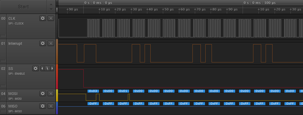

  • Just to make sure I am fully understanding the interrupt trigger, here is another analyzer screenshot showing the reading of 256 bytes of data.
    So the first 4 bytes 0x03 0x00 0x01 0x00 are command / address bytes which means reading bytes from starting address of 0x000100. Since the flash memory is mostly empty. most of the return bytes are 0xFF.
    So initially, since the TX FIFO is empty, the TX interrupt is fired. Then there is another interrupt which occurred between the 3rd and 4th data byte which I believe is, again, the TX interrupt since the 4th data byte has left the TX FIFO (MOSI line gets the 4th data byte slightly later after it leaves the FIFO) which makes TX FIFO half full or less, so the TX FIFO is filled again. Then immediately after, RX interrupt is triggered since 4 data bytes has been received. Then the same thing repeats, TX, RX interrupt ... Is my understanding correct?
    Jacky
  • Hi Jacky,
    Yes, your understanding is correct!
