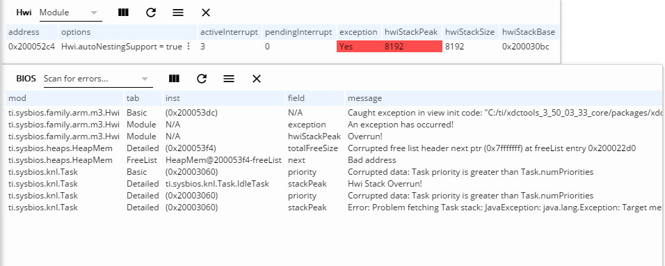

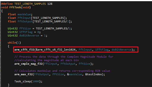

When I port CMSIS-DSP FFT function to TI-RTOS , it happens Hwi stack overrun , example code and error message as follows:
(when the red marked code is executed and then Hwi stack is overrun)
So I would like to know what causes hwi stack overrun and how to fix the issue

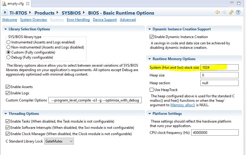

  • Hi Jeff,
     I think you run out of the stack with the fft function Try to increase the stack size. You should be to use the TI-RTOS ROV to find out the status of the stack - how much was allocated/used, etc. Below in the highlighted field in yellow is where you can change the Hwi stack size.
