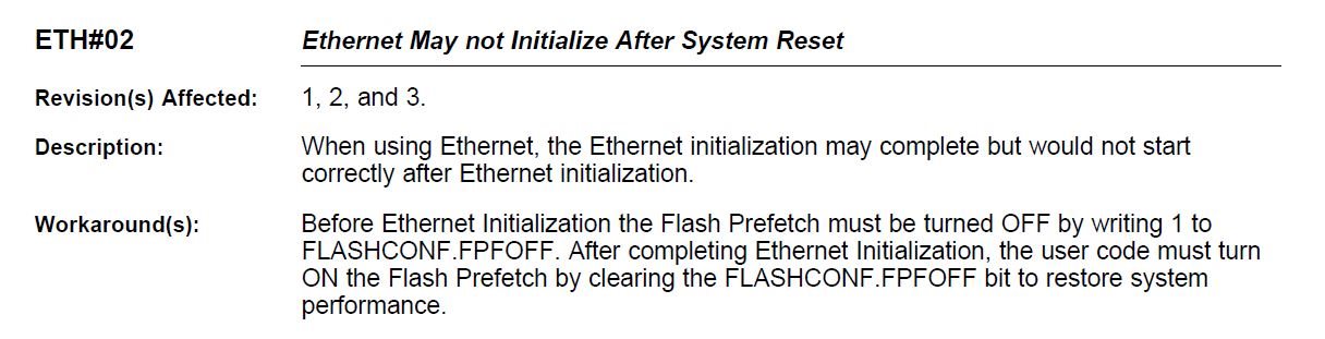

  • Hi Cristina,
     Not sure if you are facing the below errata. Please try to implement the workaround by turning off the flash prefetch before the PHY initialization and turn it back on after the initialization is complete. Please also refer to this posts. i will also suggest that you isolate the problem by first running only one peripheral (your display function or etc) with system clock configured at 120MHz and find out why they won't work at 120MHz.
    processors.wiki.ti.com/.../TI-RTOS_TM4C129_Emac_Issues
