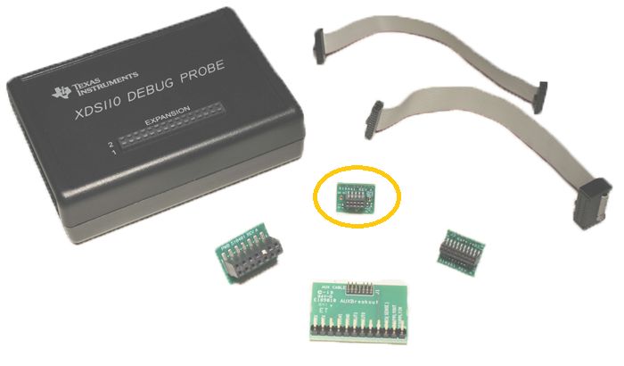

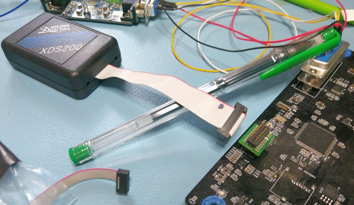

  • Hi Steve,
    Just dug a big deeper into this. I checked TI's "actual" XDS110 manual on this document:
    www.ti.com/.../sprui94.pdf
    Conclusions:
    - Yes, our pinout shown above matches the XDS110 mapping, according to CM10 column on document entry 4.1.2
    - To use the board connector that I've shown on my first reply, the adapter that you will use (original on the XDS110 package) is the one in the middle on the picture below.
    The exact same situation applies if using, for example, an XDS200, like shown on the next image (same target board as the first picture I sent this morning).
    Hope this is of help.
    Cheers
    Bruno
