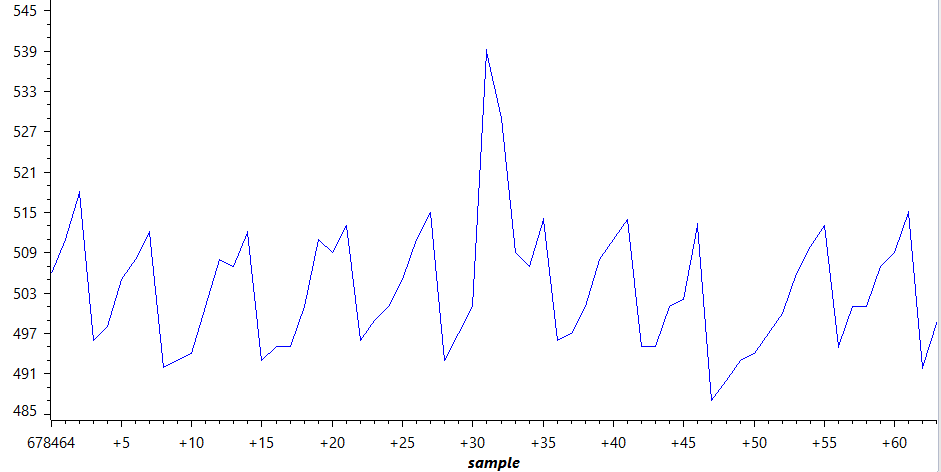

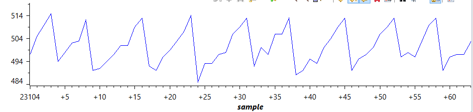

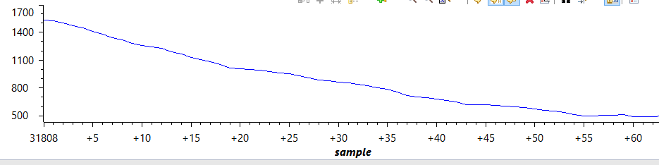

Hey Bob, I was working on a project involving sampling external analog signal. I saw your post above in which you provided with a example file. So, I tried to run the code with small modification as I am working on DK-TM4C129X. My project files are attached below.

#define ADC_SAMPLE_BUF_SIZE     64
enum BUFFERSTATUS
                  { EMPTY,
                    FILLING,
                    FULL
#pragma DATA_ALIGN(ucControlTable, 1024)
uint8_t ucControlTable[1024];
static uint16_t ADC_Out1[ADC_SAMPLE_BUF_SIZE];
static uint16_t ADC_Out2[ADC_SAMPLE_BUF_SIZE];
static enum BUFFERSTATUS BufferStatus[2];
void ConfigureUART(void);
void init_ADC(void);
void init_TIMER(void);
void init_DMA(void);
static uint32_t g_ui32DMAErrCount = 0u;
static uint32_t g_ui32SysTickCount;
void uDMAErrorHandler(void)
    uint32_t ui32Status;
    ui32Status = MAP_uDMAErrorStatusGet();
    if(ui32Status)
        MAP_uDMAErrorStatusClear();
        g_ui32DMAErrCount++;
// Not used in this example, but used to debug to make sure timer interrupts happen
void Timer0AIntHandler(void)
    // Clear the timer interrupt flag.
    TimerIntClear(TIMER0_BASE, TIMER_TIMA_TIMEOUT);
void SysTickIntHandler(void)
    // Update our system tick counter.
    g_ui32SysTickCount++;
void ADCseq0Handler()
    ADCIntClear(ADC0_BASE, 0);
    if ((uDMAChannelModeGet(UDMA_CHANNEL_ADC0 | UDMA_PRI_SELECT) == UDMA_MODE_STOP)
            && (BufferStatus[0] == FILLING))
        BufferStatus[0] = FULL;
        BufferStatus[1] = FILLING;
    else if ((uDMAChannelModeGet(UDMA_CHANNEL_ADC0 | UDMA_ALT_SELECT) == UDMA_MODE_STOP)
            && (BufferStatus[1] == FILLING))
        BufferStatus[0] = FILLING;
        BufferStatus[1] = FULL;
int main(void)
    uint32_t i, average1, average2, samples_taken;
    // Set the system clock to run at 80MHz from the PLL.
    //SysCtlClockSet(SYSCTL_SYSDIV_2_5|SYSCTL_USE_PLL|SYSCTL_OSC_MAIN|SYSCTL_XTAL_16MHZ);
    SysCtlClockFreqSet((SYSCTL_XTAL_25MHZ |
                            SYSCTL_OSC_MAIN |
                               SYSCTL_USE_PLL |
                              SYSCTL_CFG_VCO_480), 120000000);
    SysCtlDelay(20u);
    MAP_SysCtlPeripheralEnable(SYSCTL_PERIPH_TIMER0);  //Enable the clock to TIMER0
    MAP_SysCtlPeripheralEnable(SYSCTL_PERIPH_ADC0);    //Enable the clock to ADC module
    MAP_SysCtlPeripheralEnable(SYSCTL_PERIPH_UDMA);    //Enable the clock to uDMA
    MAP_SysCtlPeripheralEnable(SYSCTL_PERIPH_GPIOE);   //Enables the clock to PORT E
    MAP_SysCtlDelay(30u);
    MAP_SysTickPeriodSet(SysCtlClockGet() / 100000u); //Sets the period of the SysTic counter to 10us
    MAP_SysTickIntEnable();
    MAP_SysTickEnable();
    BufferStatus[1] = EMPTY;
    samples_taken = 0u;
    ConfigureUART();
    UARTprintf("Timer->ADC->uDMA demo!\n");
    UARTprintf("\tAverage1\tAverage2\tTotal Samples\n");
    init_DMA();
    init_ADC();
    init_TIMER();
    MAP_IntMasterEnable();
    MAP_TimerEnable(TIMER0_BASE, TIMER_A); // Start everything
    while(1)
        if(BufferStatus[0u] == FULL)
            // Do something with data in ADC_OUT1
            average1 = 0u;
            for(i =0u; i < ADC_SAMPLE_BUF_SIZE; i++)
                average1 += ADC_Out1[i];
                ADC_Out1[i] = 0u;
            BufferStatus[0u] = EMPTY;
            // Enable for another uDMA block transfer
            uDMAChannelTransferSet(UDMA_CHANNEL_ADC0 | UDMA_PRI_SELECT, UDMA_MODE_PINGPONG, (void *)(ADC0_BASE + ADC_O_SSFIFO0), &ADC_Out1, ADC_SAMPLE_BUF_SIZE);
            uDMAChannelEnable(UDMA_CHANNEL_ADC0 | UDMA_PRI_SELECT); // Enables DMA channel so it can perform transfers
            samples_taken += ADC_SAMPLE_BUF_SIZE;
            average1 = (average1 + (ADC_SAMPLE_BUF_SIZE / 2u)) / ADC_SAMPLE_BUF_SIZE;
        if(BufferStatus[1u] == FULL)
            // Do something with data in ADC_OUT2
            average2 = 0u;
                average2 += ADC_Out2[i];
                ADC_Out2[i] = 0u;
            BufferStatus[1u] = EMPTY;
            uDMAChannelTransferSet(UDMA_CHANNEL_ADC0 | UDMA_ALT_SELECT, UDMA_MODE_PINGPONG, (void *)(ADC0_BASE + ADC_O_SSFIFO0), &ADC_Out2, ADC_SAMPLE_BUF_SIZE);
            uDMAChannelEnable(UDMA_CHANNEL_ADC0 | UDMA_ALT_SELECT);
            average2 = (average2 + (ADC_SAMPLE_BUF_SIZE / 2u)) / ADC_SAMPLE_BUF_SIZE;
            UARTprintf("\t%d\t\t%d\t\t%d\r", average1,average2,samples_taken);
void init_TIMER()
    MAP_TimerConfigure(TIMER0_BASE, TIMER_CFG_SPLIT_PAIR | TIMER_CFG_A_PERIODIC);
    // Set sample frequency to 16KHz (every 62.5uS)
    MAP_TimerLoadSet(TIMER0_BASE, TIMER_A, MAP_SysCtlClockGet()/16000 -1);   //TODO: Timer Load Value is set here
    MAP_TimerControlTrigger(TIMER0_BASE, TIMER_A, true);
    MAP_TimerControlStall(TIMER0_BASE, TIMER_A, true); //Assist in debug by stalling timer at breakpoints
void init_ADC()
    GPIOPinTypeADC(GPIO_PORTE_BASE, GPIO_PIN_2);
    SysCtlDelay(80u);
    // Use ADC0 sequence 0 to sample channel 0 once for each timer period
    ADCClockConfigSet(ADC0_BASE, ADC_CLOCK_SRC_PIOSC | ADC_CLOCK_RATE_HALF, 1);
    SysCtlDelay(10); // Time for the clock configuration to set
    IntDisable(INT_ADC0SS0);
    ADCIntDisable(ADC0_BASE, 0u);
    ADCSequenceDisable(ADC0_BASE,0u);
    // With sequence disabled, it is now safe to load the new configuration parameters
    ADCSequenceConfigure(ADC0_BASE, 0u, ADC_TRIGGER_TIMER, 0u);
    ADCSequenceStepConfigure(ADC0_BASE,0u,0u,ADC_CTL_CH0| ADC_CTL_END | ADC_CTL_IE);
    ADCSequenceEnable(ADC0_BASE,0u); //Once configuration is set, re-enable the sequencer
    ADCIntClear(ADC0_BASE,0u);
    ADCSequenceDMAEnable(ADC0_BASE,0);
    IntEnable(INT_ADC0SS0);
void init_DMA()
    uDMAEnable(); // Enables uDMA
    uDMAControlBaseSet(ucControlTable);
    uDMAChannelAttributeDisable(UDMA_CHANNEL_ADC0, UDMA_ATTR_ALTSELECT | UDMA_ATTR_HIGH_PRIORITY | UDMA_ATTR_REQMASK);
    uDMAChannelAttributeEnable(UDMA_CHANNEL_ADC0, UDMA_ATTR_USEBURST);
    // Only allow burst transfers
    uDMAChannelControlSet(UDMA_CHANNEL_ADC0 | UDMA_PRI_SELECT, UDMA_SIZE_16 | UDMA_SRC_INC_NONE | UDMA_DST_INC_16 | UDMA_ARB_1);
    uDMAChannelControlSet(UDMA_CHANNEL_ADC0 | UDMA_ALT_SELECT, UDMA_SIZE_16 | UDMA_SRC_INC_NONE | UDMA_DST_INC_16 | UDMA_ARB_1);
    uDMAChannelEnable(UDMA_CHANNEL_ADC0); // Enables DMA channel so it can perform transfers
// Configure the UART and its pins.  This must be called before UARTprintf().
void
ConfigureUART(void)
    // Enable the GPIO Peripheral used by the UART.
    MAP_SysCtlPeripheralEnable(SYSCTL_PERIPH_GPIOA);
    // Enable UART0
    MAP_SysCtlPeripheralEnable(SYSCTL_PERIPH_UART0);
    // Configure GPIO Pins for UART mode.
    MAP_GPIOPinConfigure(GPIO_PA0_U0RX);
    MAP_GPIOPinConfigure(GPIO_PA1_U0TX);
    MAP_GPIOPinTypeUART(GPIO_PORTA_BASE, GPIO_PIN_0 | GPIO_PIN_1);
    // Use the internal 16MHz oscillator as the UART clock source.
    UARTClockSourceSet(UART0_BASE, UART_CLOCK_PIOSC);
    // Initialize the UART for console I/O.
    UARTStdioConfig(0, 115200, 16000000);

I gave analog signal input as a square wave of 1kHz and 1Vpp at PE2 from a function generator and connected ground of function generator pin to board's ground. When I ran this code in CCSv6, the buffers ADC_Out1 and ADC_Out2 were filled, and when I plotted them using CCS graph window, how do I verify if the values are correct or not? Like I should get a square wave or part of it in graph, but it was nothing like that. My ADC_Out1 was plotted like this.
And ADC_Out2 was like this:
Can you please help me to figure out whats wrong or how can I get something similar to sqaure wave as an output in array, because my project involves calculation of FFT after getting that array.
And one more question, can I just change the buffer size to like 128,256 or high to get large buffer size or do I also have to change some uDMA part of the code also?

    This is the ADC_Out2 plot:
    This is ADC_Out1 plot:
    Is this correct or not? I am not able to verify this.
