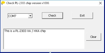

  • Thanks a lot! the driver + Tx/Rx cable did the trick :)
  • after installing the driver, i can see the device is ok - "prolific usb to serial". i tried executing "PL2303_CheckChipVersion_v1006.exe" which came with the driver with the correct com port and got a good response:

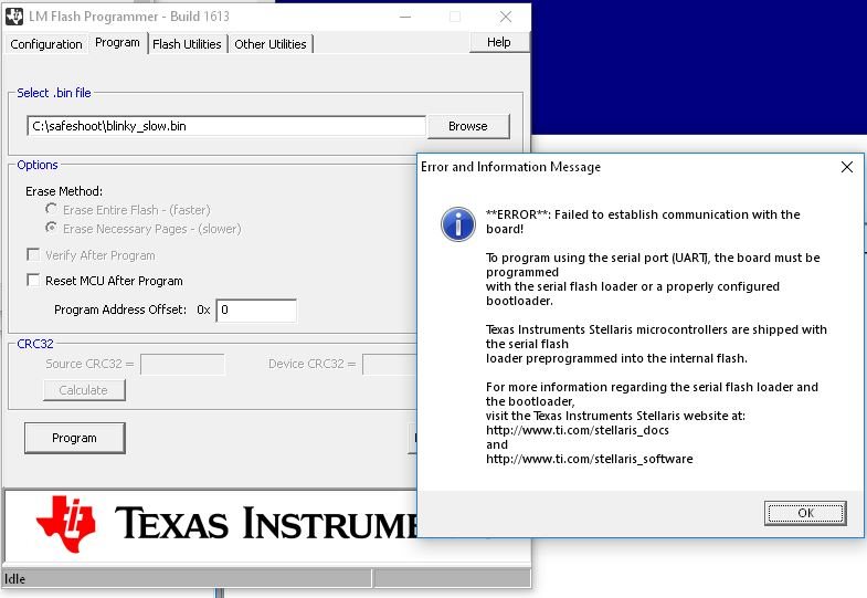

    what i'm trying to do now is program the chip using the flasher tool with blink bin image through UART to make sure that the process works:
    when i try "program", i get the following error:
    i tried doing this after programming the chip through regular microusb connection with boot_demo1, boot_demo2 and boot_serial examples - none of them worked.
    what  am i doing wrong here?

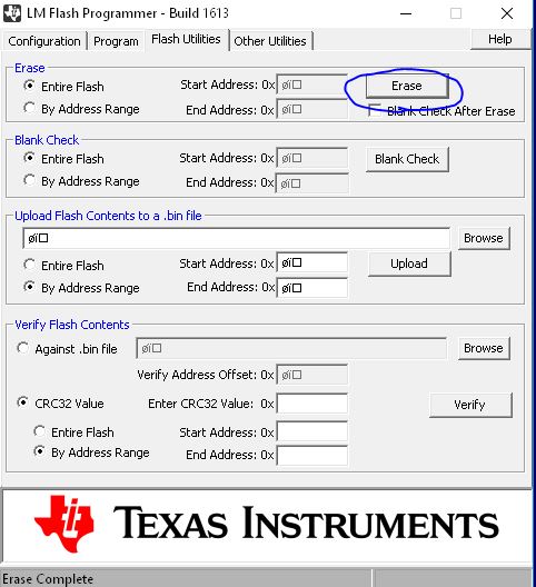

    Let's check if the issue is from the UART end or the boot loader code end. If you Flash erase the device, see if it will allow you to go into the boot loader then. By flash erasing, you will prompt the ROM boot loader to be invoked and if you can then connect to it, we know the issue is on the Flash boot loader firmware.

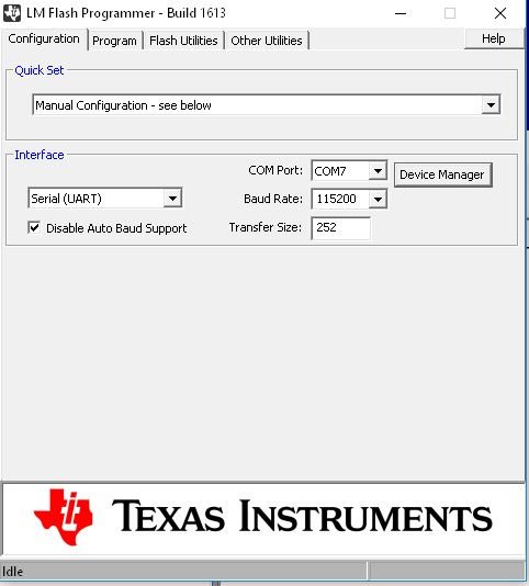

  • i'm not sure i got it. i did the following (from USB port):
    and after that trying to program through UART?
    Thanks.
  • Hello Liran,

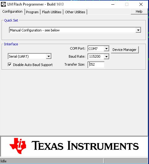

    Correct. After doing that, go back to the Manual Configuration option, select the Serial UART option, and fill in the details on baud rate etc. and then see if that will connect properly.
    Also make sure the COM port is properly configured for the right baud speed via device manager.

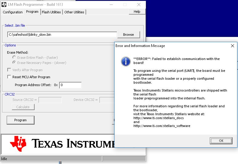

  • well, i changed the com port to 115200 (it was 9600):
    and did the erase again with these settings:
    and i'm still getting the error:
    however, i believe the communication is ok with the cable since by running the driver test app as i did before (PL2303_CheckChipVersion_v1006.exe) produces a good response:
    what do you think?

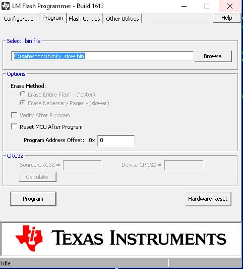

    I was able to download code via boot loader with my FTDI cable. Here are the steps I have taken.
    1) Validated FTDI cable functionality by testing uart_echo
    2) Importing "boot_serial" example from TivaWare for the EK-TM4C1294XL LaunchPad which is default configured for UART0.
    3) Build and flashed "boot_serial" to LaunchPad
    4) Connect to LMFlash with Serial (UART)
    4a) Verified the setting for Baud Rate is 115200 (also ensured Device manager was confirmed for 115200 Baud)
    4b) Kept transfer size set to 60 (default) and "Disable Auto Baud Support" checked
    5) Went to program tab and browsed to an example for TM4C1294NCPDT (in this case, I imported and compiled "blinky" in CCS)
    6) Clicked Program. LMFlash downloaded the program with no issues, reporting back that Programming was Completed.

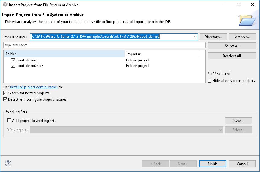

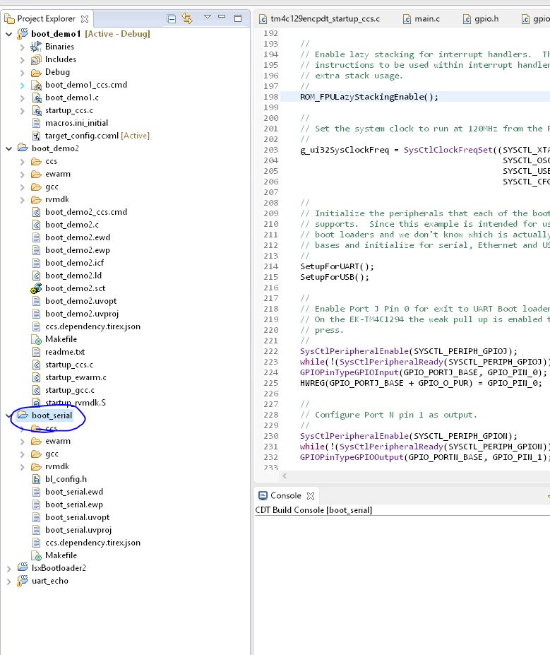

  • Hi Ralph.
    i finally found the issue why i couldn't upload through UART after flashing boot_serial.bin - i have to check "Reset MCU after program" to make it work. as i'm coming from arduino world, i didn't know that it doesn't restart at the end of the programming - this problem is finally solved.
    however - i have a few questions:
    1. when i upload the boot_demo1 by clicking on it and then -> debug, the led starts to blink, but if i disconnect the device's power cables (powering off) and then reconnect them, the led does not blink - why? isn't the program supposed to start the same way on power off/power on?
    2. sometimes projects are not becoming active when i click on them, for example - i cannot make boot_demo2 active (see picture 2 to see how i open it and 3 - as it's not becoming active after clicking it) - why is that? if i try to open only the nested boot_demo2/ccs folder it using  "open project from file system" -> it can be made active but it won't compile.
    3. i cannot make boot_serial active so i cannot debug it - see picture 1 (i've noticed it has no main.c?).
    i've created a fresh new project for the chip and implemented blinky with it to see what project changes i need to make it work and it is working fine. the next step is to add the bootloader code to this project to make it both blink and listen for programming from UART, but i need a working example which i can debug in order to understand what i need to implement in my project.
    boot_demo1 is working strange as i described in q1, but even if i try to upload a program after pressing SW1 (right after debug->start) it won't load and present the regular communication error.
  • Hello Liran,
    It doesn't look like your pictures loaded correctly.
  • sorry - attached now:
  • Hello Liran,
    It looks like there isn't a target_config.ccxml file associated with those projects.
    I don't import projects during the method you are picturing, instead I use the drop down menu titled "Project" and then select "Import CCS Projects..." That usually works well but every once in a while it won't select the .ccxml as an "Active" file, so you have right click it and find the "Set as Active Target Configuration" option.
  • thanks - with the import it DOES load ok.

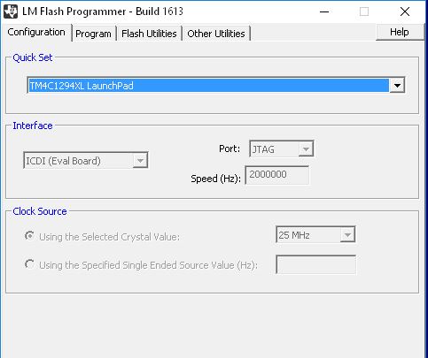

  • The behavior of debugging a project vs loading a compiled image with LM flasher seems different:
    from Code Composer studio, "blinky" is active -> pressing "Debug" and then "Resume" buttons -> result is that the led starts to blink
    power off/power on the chip - the led blinks - this is great.
    from LM flasher application:
    1. "Reset MCU after program" checked, address 0x0, configuration quick set to TM4C1294XL Launchpad, port: JTAG (uploading through USB)
    2. program the device with "c:\Users\Developer\workspace_v7\boot_serial\Debug\boot_serial.bin" (same folder used for the project)
    3. program is successful
    4. in LM flasher - change to manual configuration (UART setting)
    5. select image "c:\Users\Developer\workspace_v7\blinky\Debug\blinky.bin"
    6. program address 0x4000, "Reset MCU after program" checked
    7. "Program" button -> success.
    8. no LED is blinking
    i tried power off/on the device and still - no blinking. what can be the reason for that? is 0x4000 the right address to program it?
  • Hello Liran,
    Did you change the APP_BASE in the .cmd file for blinky to be at address 0x4000 and also adjust the code length to properly reflect the new range?
    #define APP_BASE 0x00004000
    #define RAM_BASE 0x20000000
    /* System memory map */
    MEMORY
        /* Application stored in and executes from internal flash */
        FLASH (RX) : origin = APP_BASE, length = 0x000fc000
        /* Application uses internal RAM for data */
        SRAM (RWX) : origin = 0x20000000, length = 0x00040000
    If not then likely what happened is CCS was overwriting your boot loader so it didn't seem to be as much of a problem but in LMFlash you weren't able to load the program properly.
    Note that the above code comes from the .cmd file of our boot_demo1 example.
  • that did it - thx! :)
