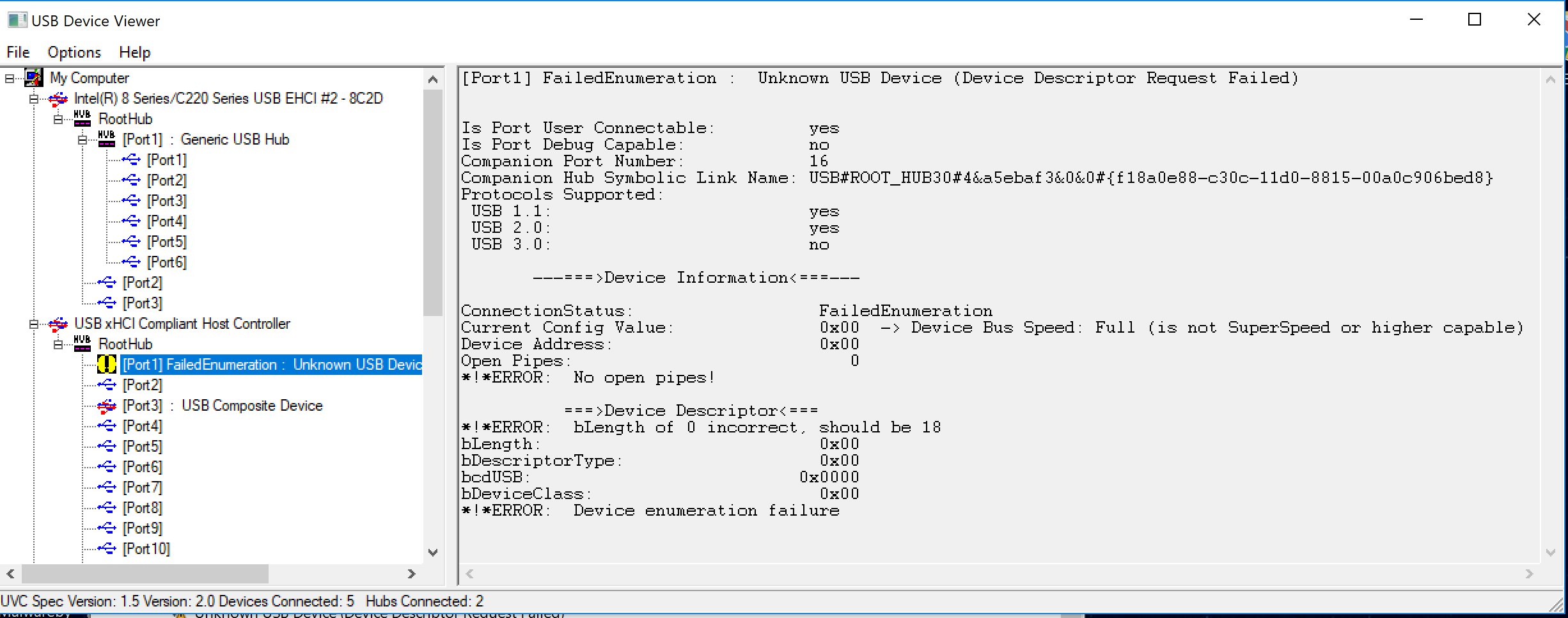

I managed to get my TIva to appear in the device manager when in USB mode, however, it is not getting enumerated. I used to Windows USB debugger to see what is happening and apparently, it is because of bLength device descriptor of a wrong length. I am a little bit confused by this because when I search the official TIva USB library documentation, bLength is mentioned in the General Purpose Functions chapter but when I actually search through the working examples, bLength does not appear anywhere. Any ideas on how to proceed?

  • Hello Jan,
    There is still a usbdaudio.c and .h file included in the latest TivaWare, so I am not sure why you need to pull a file from StellarisWare instead.
    Also I did some digging into the usbdaudio.c file and I think perhaps the issue is that the USB audio device descriptor is not properly being sent over USB.
    If you look at the g_pui8AudioDeviceDescriptor, that is stated to be the device descriptor and has a length of 18 as described. While the comments don't note that it is bLength, I don't see how it cannot be. So the issue may rather be that the TM4C is not sending the data in g_pui8AudioDeviceDescriptor over to the PC when enumerating.
    Now that I look at your image once more and closely from the original post, it is clear that the other bytes were all zero as well, so it just didn't send data, and bLength alone isn't at fault. Please look into how the g_pui8AudioDeviceDescriptor is being leveraged by your device code and see if you can find a reason as to why the data contained in that descriptor is not being properly transmitted to the PC.

  • I looked up linking and what not, tried to reconstruct the example blinky, linked everything and the example blinky worked. Did the same for my bulk device and it did not help. The somewhat infuriating fact is that the compiler does not give any warnings or errors.

  • Good morning,
    I initially tried to build on top of the bulk device example (there is no audio device example, so I couldn't start there) and I ran into the issue that I was describing earlier (bLength issues). I decided that I would recreate the bulk device example, maybe I would learn something useful. The code itself works but not within a new project, I'll attach snaps of what I am linking and the paths, see if you can find the issue? I could post the project folders, if helps.
