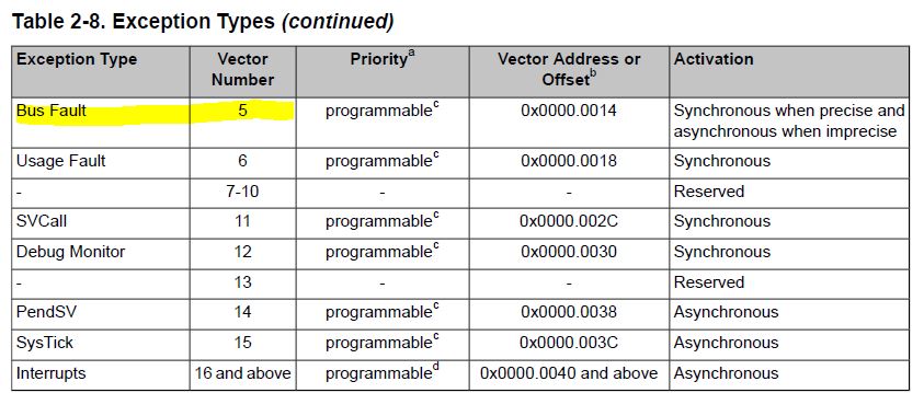

  • Hi Bala,
     46 is the GPIOF. Are you generating an GPIOF interrupt based on an edge detection from an external input? If yes, how fast is the input? Can you elaborate?
     What is the 23? The 23 is supposed to be the SSI0 according to the datasheet. But in your ROV it is showing ADC. I'm confused here.
     Which I2C is creating bus fault? When you said bus fault do you mean bus fault as in vector number 5 shown below?
     I don't think the 46 is preempted by others since you said all interrupts have the same priority. As we just went through the priority handling discussion, if two interrupts (i.e. 46 and 23) are of same priority and if both are pending at the same time then the lower exception number interrupt (i.e. 23) will take priority to be serviced. This is different from 46 is being preempted in the middle of the interrupt handling.
