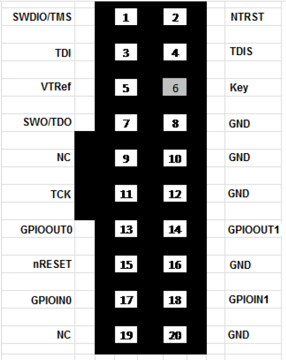

I'm trying to debug my Hercules RM57 Launchpad using the XDS110 Debug Probe. When testing the connection, I receive the following error:
"The value is '-267' (0xfffffef5).
The title is 'SC_ERR_XDS110_TARGET_SUPPLY'.
The explanation is:
The controller could not detect valid target supply. Check target
JTAG connection and/or connection setting specifying voltage level."
I have been able to successfully debug using the internal Hercules debugger. I verified that the TVRef pin was at 3.3V voltage and ran the xdsdfu tool to see if the XDS110 probe was found (which it was).
We also verified the Launchpad schematic against the XDS110 User manual and we found what we believe to be a pin mismatch.
- Launchpad Schematic:
- XDS110 User Guide:
In the user Guide, pin #8 is connected to ground but in the Schematic it seems to be connected to the external debugger. Please kindly advice what could be wrong.
Thank you.
  • Hi Surialic,
    The pin 8 of J18 on the Launchpad is used by TM4C129 device. The TM4C129 uses this signal to decide which emulator is used. If this signal is pulled low, the external emulator is used; otherwise, the internal XDS110 is used. This signal should not affect the connection of your external emulator.

  • Hello QJ Wang,
    The problem was that I needed to use the 14 pin header instead of the 20 pin one. It was not so easy since I had to get jumpers soldered into the board with little space between them but it did resolve the problem.
    Thanks for your help.
