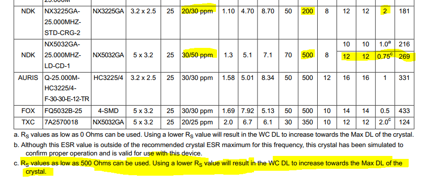

I have a doubt related to crystal . I have verified the datasheet for TM4C129NCPDT. While using the ethernet connection required 25MHz crystal with +/- 50ppm. In that thing whether both frequency tolerance and frequency stability has 50ppm or there is a difference??. If difference in tolerance and stability what will be the difference in ppm. Kindly explain. In below picture which i have to choose??
In TM4C129ENCPDT page no.1965 mentioned the 25MHz crystal details but i have an doubt in Rs value . If i selected the 500uW Max drive level crystal then what will be the Rs value??? because they had mentioned Rs value not exceed 500ohms but manufacturer mentioned 750ohms
Kindly clarify it
    The tolerance is the allowable deviation from the specified frequency when looking at the crystal alone. Frequency Stability refers to the deviation from the nominal frequency encompassing other components in the loop.
    All I can say is that If you are choosing one the listed 25MHz crystals then they are simulated by TI to be working. If you are choosing crystals from other vendors not listed then they should work if they have nearly identical crystal parameters and you use the recommended component values listed in the table.
