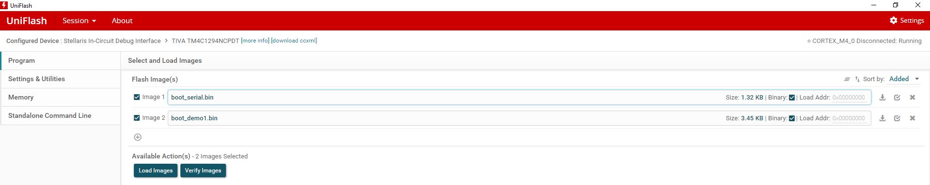

I'm using Uniflash for Windows to flash a TM4C129DNCPDT. This software can flash .bin in Tiva (or xdsdfu.exe utility with command line). Necessary to flash a several hex-files with (pauses to write EEPROM). The best method to this may be script for .bat file and USB interface (DFU).
Whether there is a utility for programming of .hex file in TM4C on DFU with a command line? (like a xdsdfu.exe for .bin)
