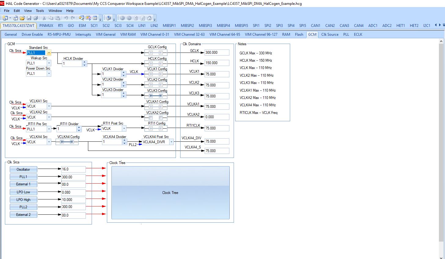

I have a TIVA C series TM4C123G launchpad and am looking for a framework software that generates the driver code that I can use on the launchpad. The PIC has Harmony and STM uses cubeMx which allows you to visually develop code specializing the drivers you can use. I am biased towards TI based upon the MSP430 but am focusing on using TI products, I want to find a tool that is similar to Harmony or cubeMX but for TI. I downloaded Tivaware but it seemed like it was a bunch of drivers.
Please let me know if TI has a similar tool. The best way to understand the drivers from what I have found is using that type of software as well as not using it for development.
  • Hi Ronald,
     Unfortunately, we don't have such GUI based tool that configures the device(i.e. clocks, peripherals and etc) and generates the C code for TM4C123. The TivaWare is a suite of software tools and libraries that facilitates the development of Tiva C Series-based MCU applications. It is actually quite easy to use. There are many examples that are provided in TivaWare to get you started.
     In another TI device family (TMS570) that I'm familiar with, it does provide a GUI based tool (HalCoGen tool) to generate the C code per user's custom configuration. Below is a screenshot of the tool showing how the clocks are configured.

  • Thanks Charles, I have looked at the HalCoCen SW and the Hercules processor family. This does solve my question, I will continue with the TIVAware and utilize the drivers and libraries. It's unfortunate that the TIVAware doesn't have a tool like this but I it just provides me the challenge to know the tivaware drivers.
