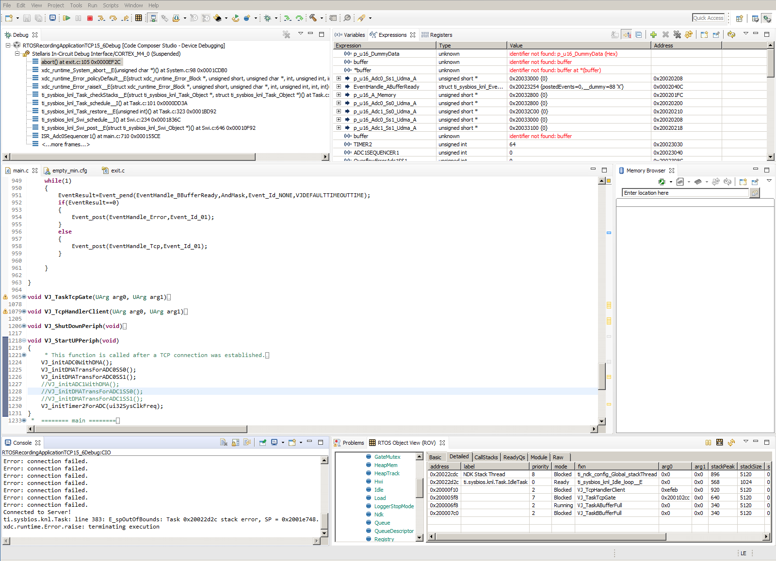

I am working with an EK-TM4C129EXL and I am using TI-RTOS 2.16.0.08 and NDK 2.25.00.09.
To give you a little bit of background. My Application should sample 20 ADC channels and send them via TCP to a Computer. The ADC channels are sampled by 2 ADCs which are using 2 Sequencers. The samples are then copied by the DMA in a ping pong transfer fashion. After a ping transfer is finished, ping should be transmitted via TCP while pong is filled with new samples.
The ISRs for the ADC sequencers are calling SWIs to reenable( uDMAChannelTransferSet ) the DMA transfers. The SWIs are posting a event to indicate that the corresponding memory, either ping or pong, is full. A task is pending on the corresponding events in order to indicate a different task which memory should be transferred via TCP.

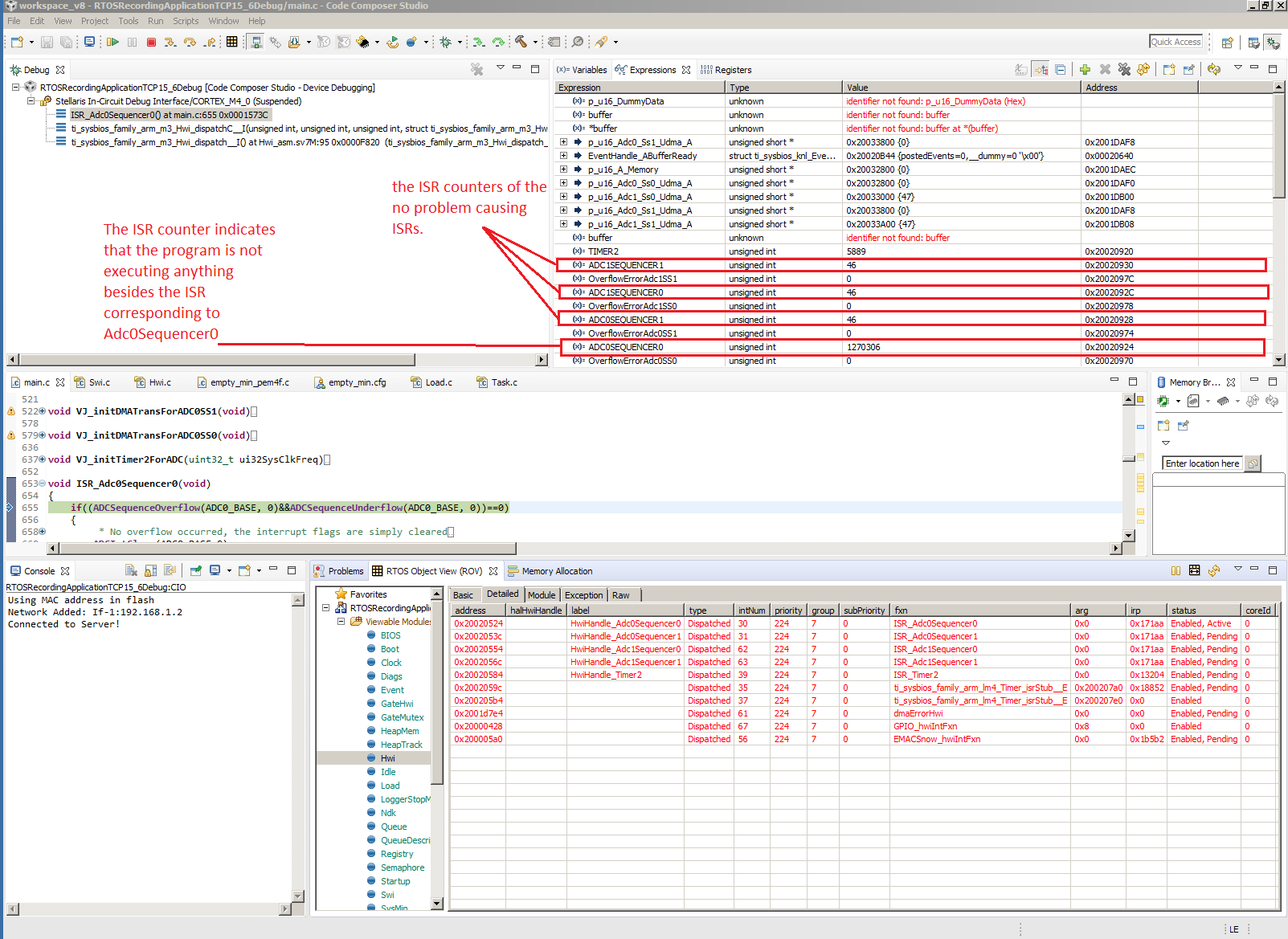

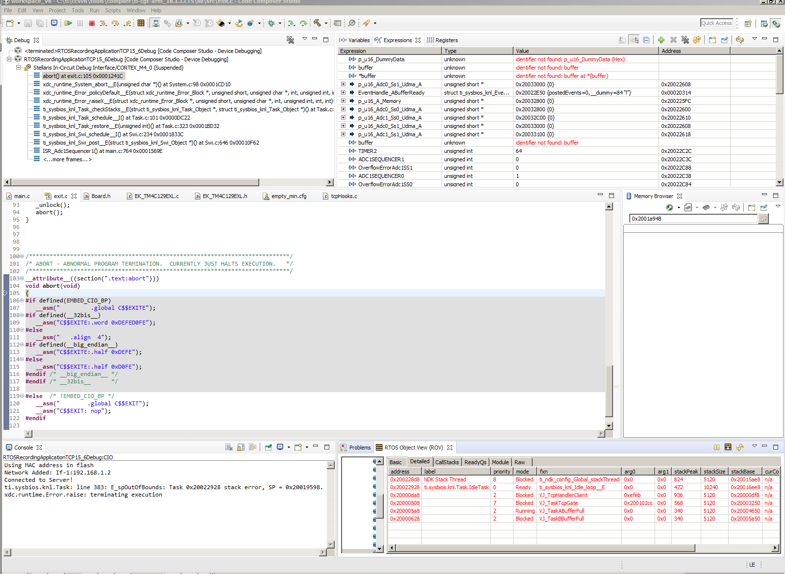

The error I am facing is as following. The IDLE task is producing a exception, I think its a stack overflow, after the ISR corresponding to ADC1Sequencer1 is executed. In the following a screenshot, which shows the error msg and the ROV in order to see that the task which is causing the problem is the IdleTask.
As you can see I already tried to rise the StackSize of all tasks and if I am interpret the ROV correct the stack sizes should be more then big enough. I'm grateful for every idea how to solve the problem. In the following I also attach the my .cfg file, maybe it is something wrong there.

    Charles Tsai said:
    You have already reserved 10240 bytes of stack for the idle task which is a lot in my opinion. I would instead try to increase the default task stack size to 2048 instead of 1024 as what you currently have and also revert the idle stack size from 10240 to 2048 and see if that makes a difference.
    I only increased the idle stack size to rule out that this could cause any problem. I switched it back and increased the default stack size ass suggested but the error still exists.
    Charles Tsai said:
    One thing to also make sure is that you can only have one task to pend on one event object at a time. You cannot have multiple tasks pending on the same event object. For example, do you have multiple tasks that will unblock based on EventHandle_ABufferReady? Perhaps you don't have such issue but just wanted to make sure.
    Only a single task, VJ_TaskABufferFull for the EventHandle_ABufferReady and VJ_TaskBBufferFull for the EventHandle_BBufferReady, is pending on the events. And only the SWIs are posting to them, I hope that isn't a problem. But I checked it in the documentation and it shouldn't be.
    Charles Tsai said:
    Another question I have is if you first limit your application to only ADC0 and not using ADC1 will it work without any error? It will be easier to start with something small and making sure it works before adding incremental capabilities.
    I checked that and the error also occures if only a single ADC, ADC0, is running. The only difference is that then the error occurs after ISR_Adc0Sequencer1. Here the screenshot of the debugging session:
    I again post my .cfg file with the changes I made, just to make shure I did everything as you suggested.

    Richard
    I have some "new" results. I switched the priority of the HWI in order to let them be under the control of the RTOS, their type is now "Dispatched" and not "zero Delay" anymore. This helped to get rid of the strange exception behavior described in the earlier post.  But this helped just to delay the problem. After about 40 to 50 TCP transfers, that means the ADCs and the DMA transfers are running without problems, the HWI corresponding to Adc0Sequencer0 are causing problems. It seems as the interrupt is never cleared or stay always active without a chance for the OS to do anything else as executing the corresponding ISR. I can tell that cause a counting variable is incremented in the ISRs. No other ISRs are executed, no tasks and Swis as well. So to me it still seems like a OS/Stack/MemoryLeak problem but I am out of Ideas. In the following a screenshot of the ROV and a copy of my .cfg file so that you can see my changes.
    And here my .cfg file:

  • Hi Richard,
    Can you show your ISR code corresponding to the Adc0Sequencer0? I want to see how you clear the ADC interrupt flags. It looks like ISR for ADC0SEQUENCER0 keeps re-entering. Can you also try to read the interrupt flags (using ADCIntStatus) after you clear the flags. The reason is that there is a write buffer in the Cortex-M processor and it may take some cycles before the flags are actually cleared. If you clear the flags and immediately exit the ISR then it may cause the interrupt to re-enter. If you try to read the flags after you clear then it guarantees that the flags are actually cleared before the ISR is exited. Please give it a try.
  • Hi Charles,
    thank you for your replie.
    I showed it in my original post.
    I will try that first thing in the morning.
    Richard
