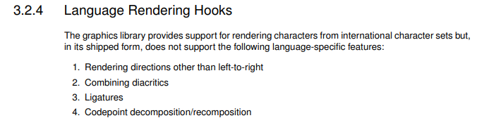

  • Hi Charles,
    i read more about the grlib and the following contains is gotten from spmu300d.pdf
    so the current grlib is supporting different encoding scheme like UTF8, iso8859-1, iso8859-2, so on. but the big issue with the rendering for the right-to-left language like the Arabic language.
    and at this point, i'm wondering if TI is going to provide the rendering of the right-to-left language in future or not. and if not, does anyone have a resource for a ready made rendering for the Arabic language?
    Mohammed Fawzy
  • Hi Mohammed,
      Unfortunately, there is currently no plan to update the graphic library for supporting right-to-left languages. I find below note in the graphic user's guide. It looks like you will need to solve the right-to-left language support by replacing the GrDefaultStringRenderer() with one which complies with the text formatting rules required by the desired languages.
    3.2.4.1 Text Rendering Direction
