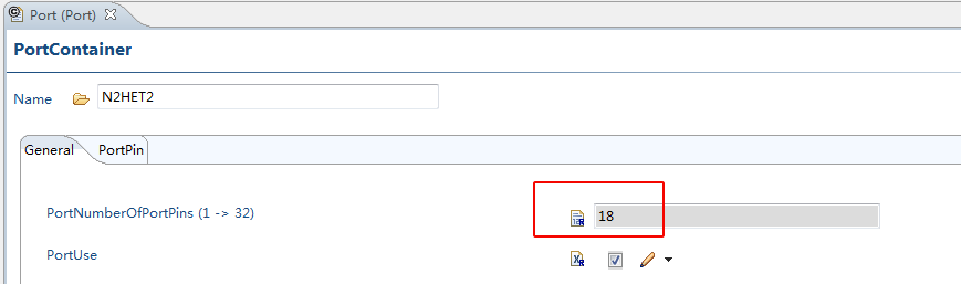

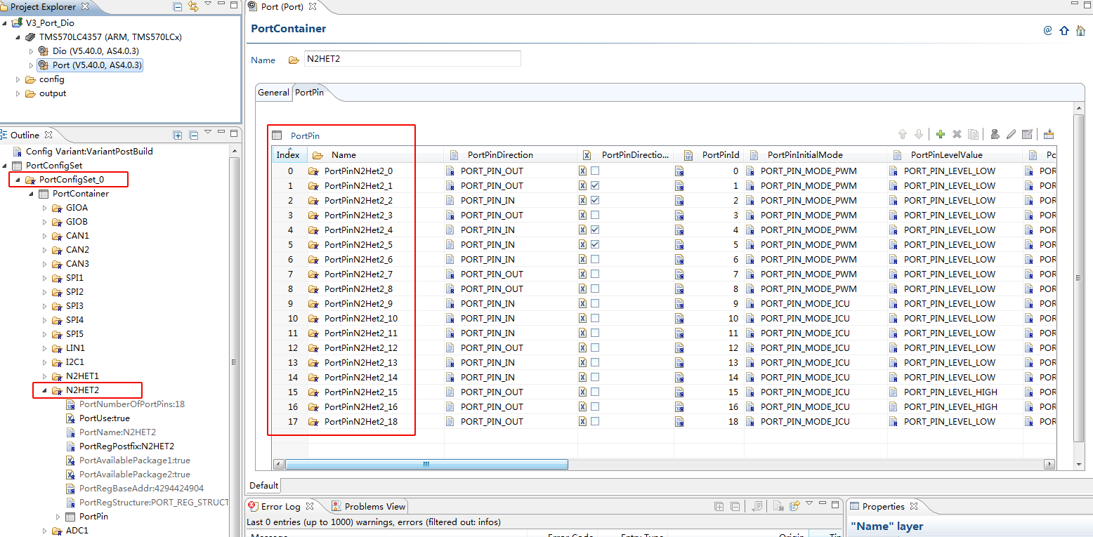

    we have a question during use EB tresos config the mcal.
    we need to use N2het2[17--23] as output high ,but in the PORT moudle ,N2Het PortPin do not have the element N2Het2_17 and N2Het[19-23],
and the PortNumberOfPortPins(1-32) is not modifiable.
how can I do N2Het PortPin config ?
